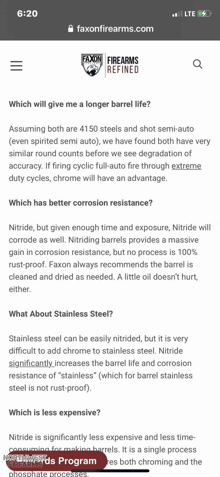

Here's an example:
https://www.m4carbine.net/showthread.php?203824-Figuring-out-a-new-Faxon-barrel
Actually from the source
Yep. Phosphate finish and CL barrels.
