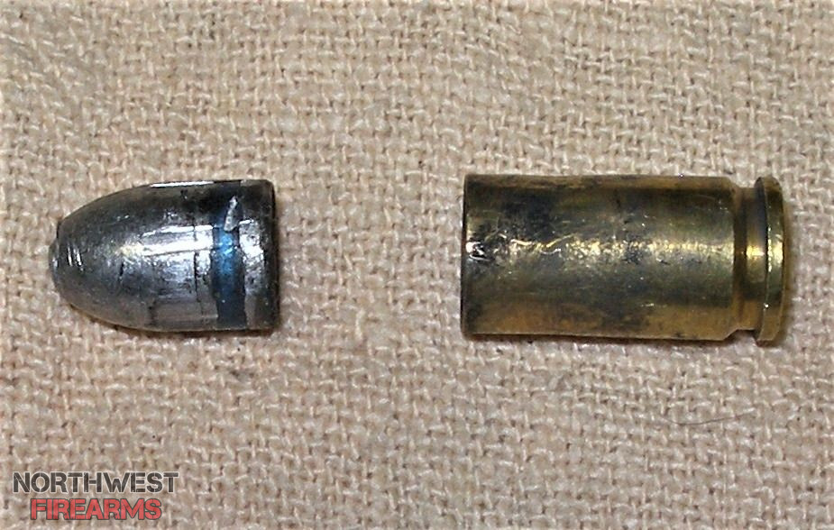

Granted, since I don't use Titegroup, I'd have to look up load data, it would be helpful to know all the specific information about your particular load. Additionally, in the interest of this squib incident, which barrel you are using in the Glock. I guarantee nobody knows where I'm going with that question.
Further, that you are using that load in the 59 without incident leads to more discussion!
Yes, you're right, I should've mentioned that the bullet is 115 gr. Primer WW small pistol (non magnum). WW case.
Yes, barrel length can matter. With a light charge, longer barrel length offers greater opportunity of getting stuck. People shooting under-powered 158 gr. jacketed bullets in older, long-barreled .38 Special revolvers have found this out to their dismay. The Glock 19 has a bbl. length of a hair over 4 inches. The Model 59 is 4 inches. The Colt is a hair over 5 inches. So there is a difference in length between the Colt and the other two guns I mentioned. But in the matter at hand, I don't think length is a factor. The first 42 shots through the Colt fired off normally. If the charge desired load had been inadequate to fire the Colt normally, my thought is that it would've been observed way before going through 42 successful shots. That is my previous experience, anyway.
Titegroup is a powder that I've found useful for 9mm. Which is a case with limited volume when loaded. Titegroup is fairly low volume. The charge I used is within the range recommended by Hodgdon for 115 gr. lead bullets. Within range on the low end, I should say. I don't like to push lead bullets too hard as it introduces other problems.

Better! Off top of my head, with regard to info in this post, something comes to mind....
Have you slugged the Colt barrel? Have you checked for leading in the Colt barrel?
If...the boolit doesnt fit the bore size(in the right way), and, if the charge is low enough not to obturate the boolit base(case is rather sooty, mebbe not sealing the chamber the best), and, if you subscribe to the gas cutting/undersize lead slug theory of leading(which I do), and, if the first 42 rounds leaded the bore.....the last round MAY have found enough resistance to moving(coupled with loss of pressure due blow-by of both the boolit and the case) to get itself stuck in the bore.
Now....the 59...is it one of the new 2019 production, low round count ones? I'm kidding.
Prolly a bit older lightly sprung, or worn springs, smooth running.....yes, a light load probably runs great in THIS 59.
As for the Glock....if the factory, polygonal rifling barrel....polygonal rifling I believe, takes less force to overcome than standard rifling.
Sound like a possible answer to why you got a stuck boolit?

All good, clear thinking. As I was shooting the Colt, I considered the possibility of leading and I checked after each of the first three magazines through, which means batteries of 8 shots per. It wasn't having an issue with leading. And when I discovered the stuck bullet, I expected that I might find such in the bore. After removing the bullet I looked in the barrel and couldn't see any lead but it wasn't yet clean. Then I did a quickie clean of the bore, meaning a few passes with a bronze brush and Hoppe's. Two patches through to soak up the Hoppe's and there was zero lead in the barrel. So I've ruled out excessive friction from lead residue.
It's true a hard bullet isn't going to obturate at lower speed than a softer bullet. Somehow, I don't think this is an issue here. I looked for gas cutting on the sidewalls of the bullet in question, didn't see any evidence of it. The gas blew back onto the casing during extraction. Mind you, the bullet was not far into the barrel, there wasn't much time for pressure to build behind the bullet before the action opened up.
I've never slugged the bore in any 9mm. Based on prior experience, I've just never thought it necessary in an auto pistol barrel from a decent manufacturer. I did mike the bullets, they were .356.
These bullets were the typical hard-cast product, Missouri Bullet Co., with hard, wax-like lube. I got them in a lot with some other stuff, in the past I've rarely fired cast bullets in 9mm because of the relatively low price of jacketed. In former times, at least. I never went to the trouble of casting my own small pistol bullets, like .32, .38, and 9mm. Which could be purchased cheaply in quantity. I saved my casting efforts for harder to get and more expensive stuff, like .38-40, .45 Colt, .45-70, etc.
The Model 59, remember when those were really hot stuff, around 1971-72, lots of people wanted them? Very old news now, so old now nobody remembers them. But the 14 round mag was sh*t-hot then. I've got a kinda large hand, the fat grip fits well. You've gotta get used to that creepy trigger, like they say about some whiskey, it's an acquired taste. I've owned several of these over the years, my experience with them has been that they will shoot just about anything. Anything will go up the ramp, stuff that won't work in the Colt or my German P.38. You don't have to do spring swaps with the 59.
The one I have at present was made in July, 1978. It's in pretty good shape, hasn't seen a huge amount of use. Came to me in the blue box with the stapled corners, along with two spare magazines. I think it might've belonged to a reserve police officer. At one time, these were almost as common on police duty belts at Glocks are now.
For a while, I had a Model 659, that was a beautiful piece of machinery. Heavier than the 59, which of course has an aluminum frame. But the 659 had sharp edges, wasn't as comfy in the hand as the 59's.
The Glock 19 will eat anything, like the 59. I haven't fired all that many lead bullets in it, mostly just to see how they worked because of the cautionary word from the factory not to do it. I had no trouble at all with the same kind of bullets used in the Colt. No leading whatsoever.
The MoBuCo hard cast lead bullets are all gone. I only had six left, I pulled those and they went into the scrap lead.
