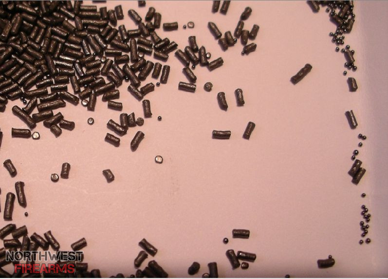

As long as attention to reloads are on the table. Some food for thought: I purchased some powder from another. Along with it came an opened can of the same stuff as gratis if you will because he was no longer going to use that product. When I finally started to load with it I notice the volume required to fill the shell looked just a little different from round to round. Poor eyes hadn't noticed at least two different miniscule size foreign material mixed in when weighing each round. the Opened can had other powders mixed in that were a tenth the size of the original powder. Egregious though it was, I believe unintentional by the previous owner of the powder.
Now I have been called a fuddyduddy many times in my life, but I am here to tell you when it comes to things like reloading it pays to be anal in your practice. I wear the title with honor!. It wouldn't hurt for you to be an honorary member too.
Showing due diligent in your loading practice will save your fingers and maybe even an eyeball or two.
baddd1.jpg No guarantees in life, but you sure can take a proactive effort to minimize failure.
