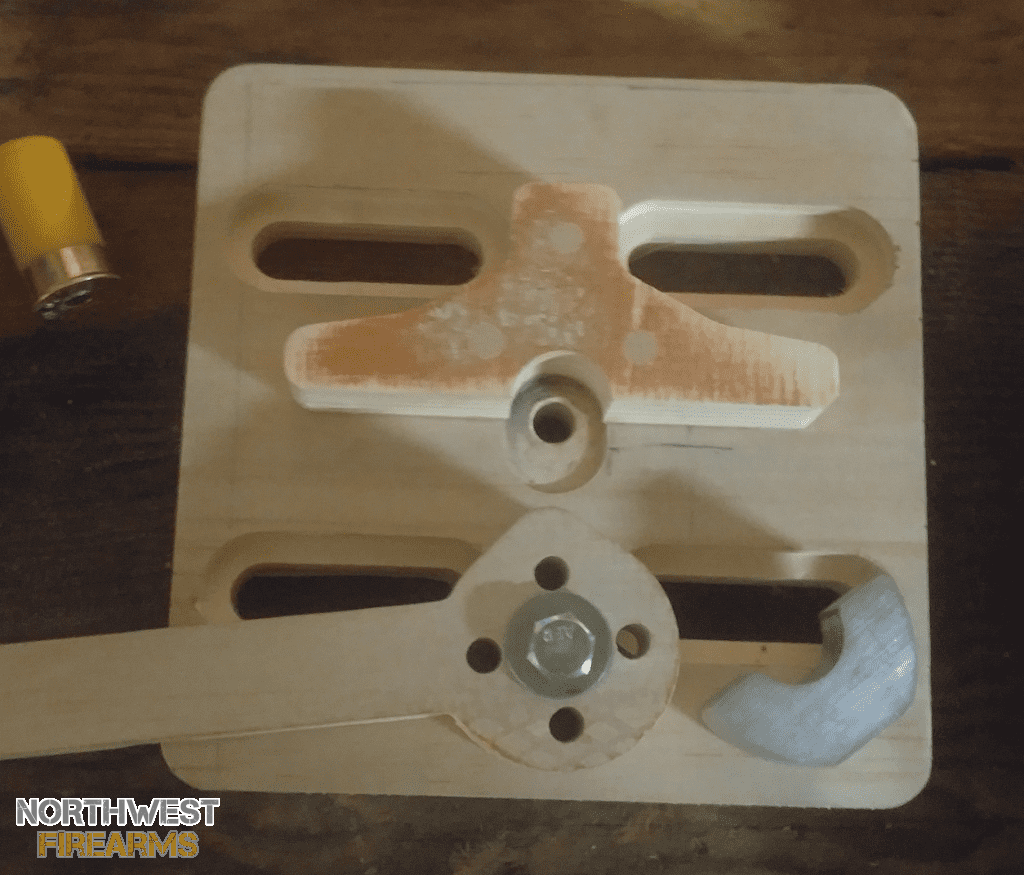

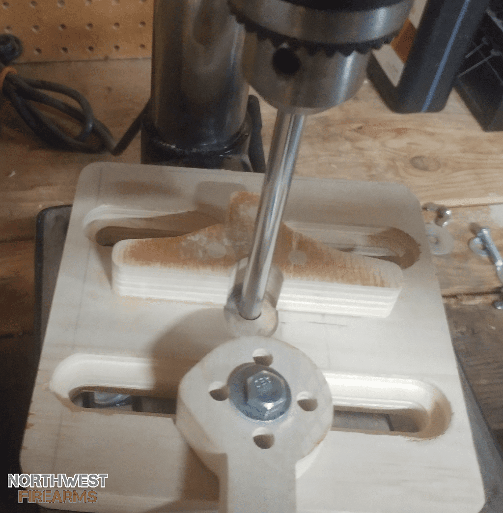

I also woke up with my hand all clawed up due to a lifetime of abuse and the recent gripping of the shells while I roll crimped. Figured it was time to make a shell clamp, so I raced through a design, cut some of the parts, realized my original all-plywood design wouldn't work because the plywood doesn't grip the shells enough and they spin when the RTO is applied. So I made a midcourse change and cut one of the clamp "jaws" out of some scrap aluminum -- I figure it sorta sticks to steel so I thought it might grip better than plywood and Indeed it did. It works well enough that I'm not going to do a v2 (I had been thinking about spring loading half the clamp but it's easy enough as is).
It mounts to the plate on my drill press. It is centered by inserting a rod into the chuck and down through the center through-hole in the base -- that hole is centered inside a depression the diameter and thickness of a shell rim. The clamp sides are the smaller diameter of the shell itself -- this keeps the rim from getting mangled because the jaws slip over top of the rim. Once it's centered, it gets bolted tight to the drill press plate and then the rod can be pulled out the bottom and the RTO installed in the chuck.
Normally I'd use both hands, left hand on the clamp lever and right on the drill, but for this video I had to also hold the camera so it's a little clumsy. In my tests, I bring the RTO down till it makes contact and centers the shell mouth, then with my left hand operate the clamp lever, and then depress the drill. But I can't do that and hold a camera but this gives the idea. I don't have a youtube account so I posted the video Imgur, where no account is needed:
EDIT: nice Imgur stuff plays automatically here. I deleted the audio so hearing nothing is normal -- it's just drill press noise.

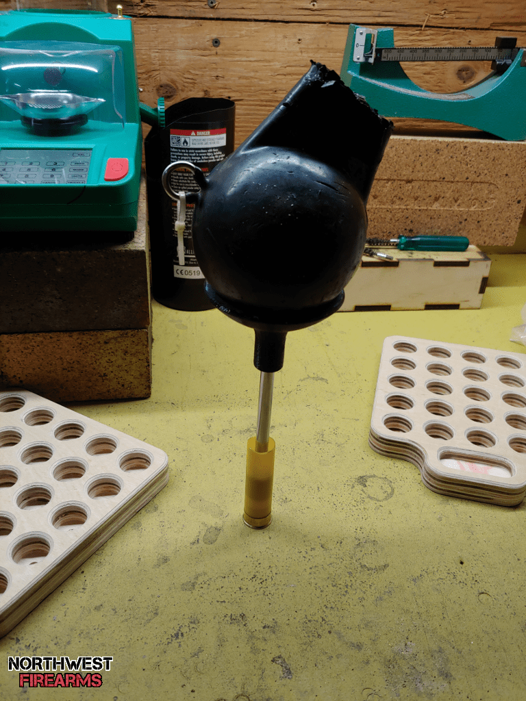

Next test. This time I used a downrigger ball (12 lb I think but I'll weigh it) and a hex bolt that fit inside the shell well to tamp the powder and patches -- not banging it, just letting the full weight rest on the stack. My hope was to improve shot to shot consistency with a measurably consistent compression technique, though think I may want to find something heavier to match the 20-40 pounds mentioned in the Lyman book. Still trying to do this without a press.
Another difference is that I used 27 gr. of buffer -- not for any specific reason, it's just what seemed to fit tonight which makes sense because as I'm digging down in the bag, the shot is noticeably heavier so I presume, bigger. I do think I packed it in a bit tight -- some of the shells look a little pimpled where the shot -- I'm going to back off on the buffer more.
Because of the compression (and increased shot weight), I decided to overlap the lowest powder weight this time with the highest from last time. I think standardizing compression helped -- aside from series C, I got some really consistent results.

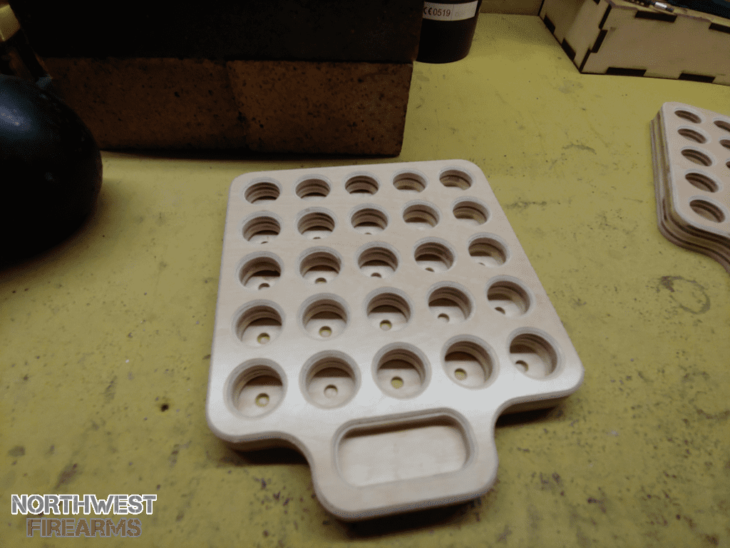

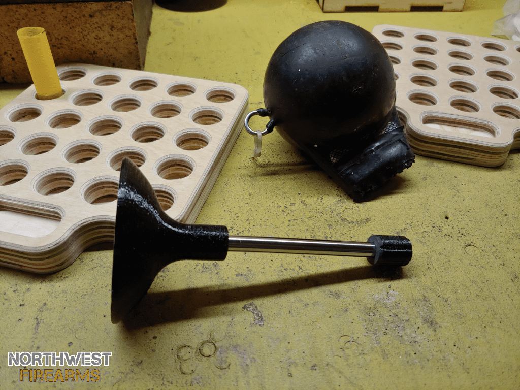

I made some tools for this project, first a loading block. I also made a holder for my downrigger weight for wad/powder compression. The contact surface has a 0.6" diameter which works out to 0.283 square inches. The weight is 8.38 pounds -- that works out to 29.6 PSI which is right in the middle of the Lyman manual's suggestion of 20 - 40 pounds of pressure (which I assumed to be PSI). I was designing a lever activated frame for the compression operation but it turned out that the the stopgap doohickey was easy to use as is.
