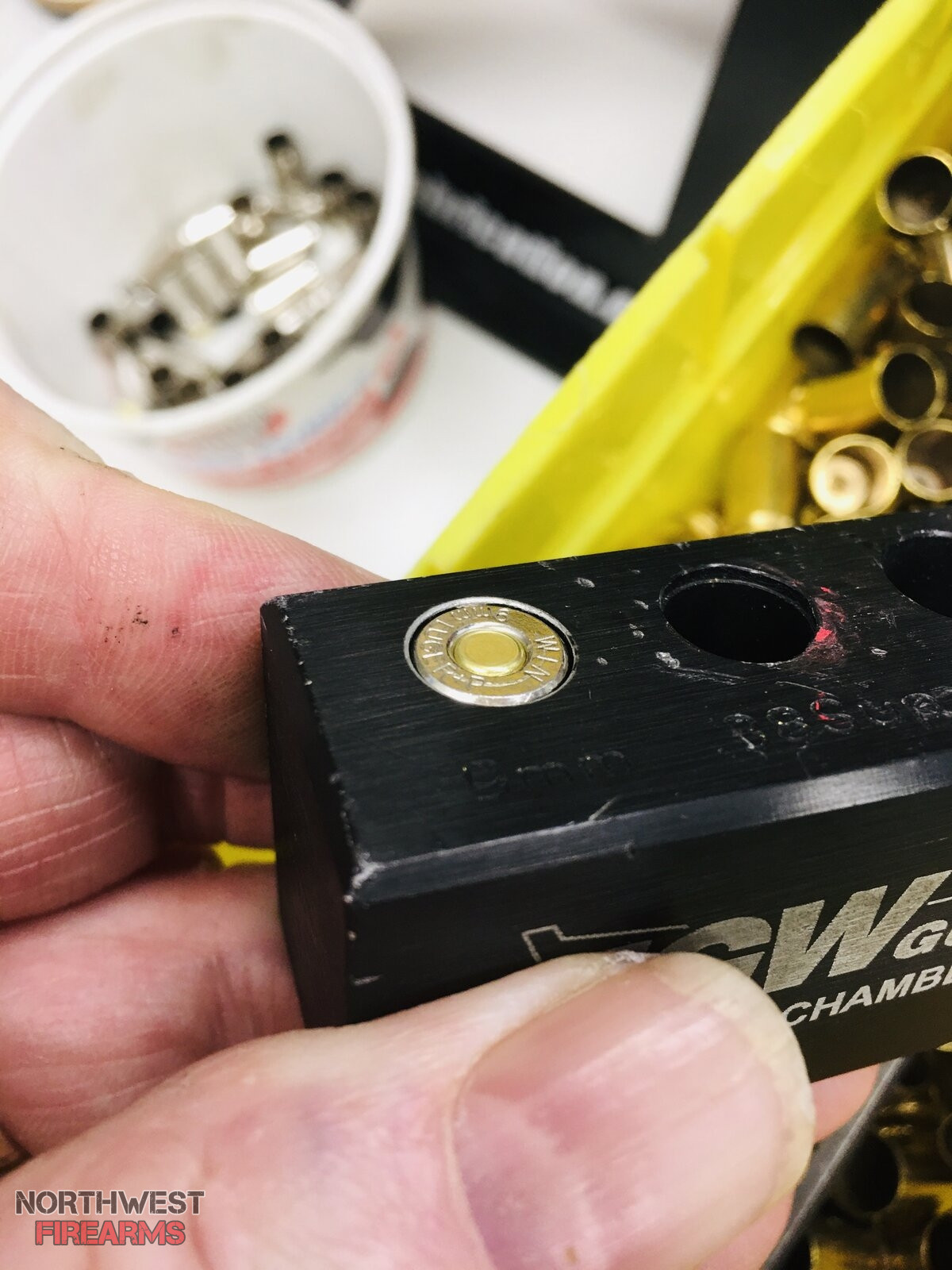

Same OAL with the shiny cases? Does the base fit in the gauge if you flip
the round and try it base first? I load that bullet long for 9 major (1.175)
and I had to throat my case gauge a bit to get the longer rounds to drop
in. Coat one with a sharpie and give it a spin to see what the holdup is.
Take a look at a EGW or Lee U die for sizing.
None are resized but the few I did resize when I checked earlier gauged fine, none hung up in the gauge.
I tried both the brass and nickel in the gauge after I resized a dozen or so, all the nickel did not pass QC, the brass did.
Just to ensure clarity...
The nickle cases did not guage AFTER resizing but BEFORE loading? In other words, and unloaded, resized case failed?
I have no idea what would cause that only with nickle cases when the die and methods used are the same as when using brass cases.
I've reloaded many thousands of nickle plated cases over the years without a y issues whatsoever.

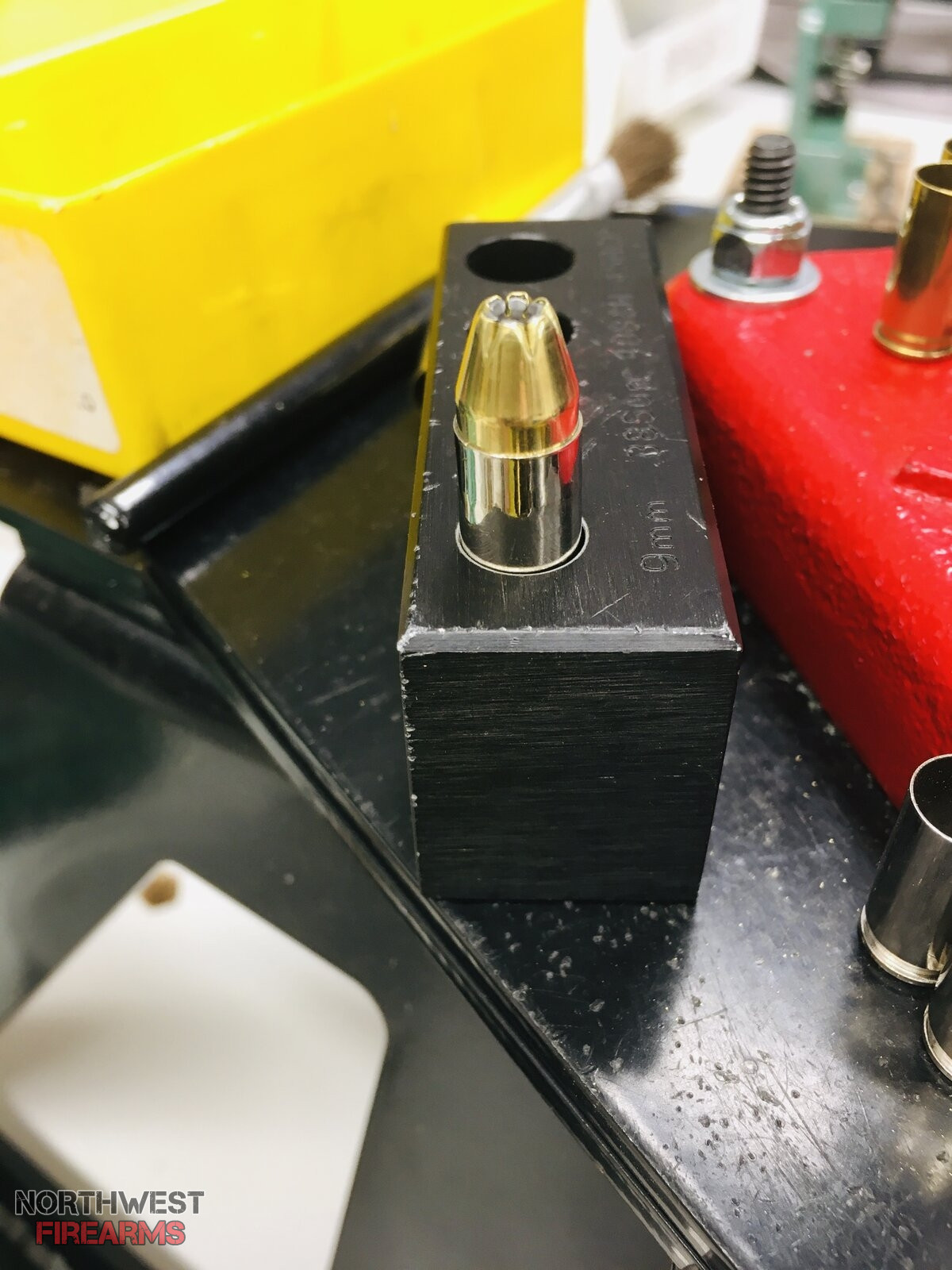

It does look to me that your bullets are seated long (picture in post 10). The shape of those hollow points required a bit shorter OAL than a typical RN profile.
But ... if you use the same OAL with the same bullet and the brass cases guage and the nickle does not the problem lies elsewhere.
I'd try reseating some of those rounds a few thousands deeper and test again. I'm betting this is your issue. If you see the round deeper in the guage but still not flush keep nudging the bullet deeper until it fits.
Go slow as you reseat and you will be fine since you used a taper crimp. Test before recrimping and keep going until the proper depth is.obtained.
Then crimp and test again to see if your crimping method is causing problems. With the Lee FCD and can't see how that would be, but who knows without testing?

Well the plunk test (barrel) did not work at all in fact I had to punch the bullet out with a rod. The next test I measured from head to the curvature of the bullet (seated at 1.120") which showed that edge was actually hitting on the case gauge.
I was told when loading these Montana gold bullets to use the load data for XTP bullets. As far as the powder weight it was fine but the COAL is wrong. In the book under 124g XTP bullets it shows the COAL at 1.120", obviously that did not work so taking the advice of one members I tried to seat it deeper by .010 increments. Gradually I noticed the bullets rounds were sitting lower in the case gauge with every adjustment and the magic number was 1.095" seating depth to pass the go-no go test.
Oh and to another member advising me to see if the head fits into the case gauge, indeed it does thanks.
Now, assuming the above is not the case and the nickle cases are dimensionality correct
Bingo. This was the problem! Thanks for planting a seed to check out.
Thanks to all who Gave their advice. It's all been entered into the memory banks, how long it stays there is up for debate. Just to make sure I'll go ahead and write this in my loading book. Lol
View attachment 1352866 View attachment 1352867 View attachment 1352868
Jim, the linked gauge would have shown the bullet hitting the throat.

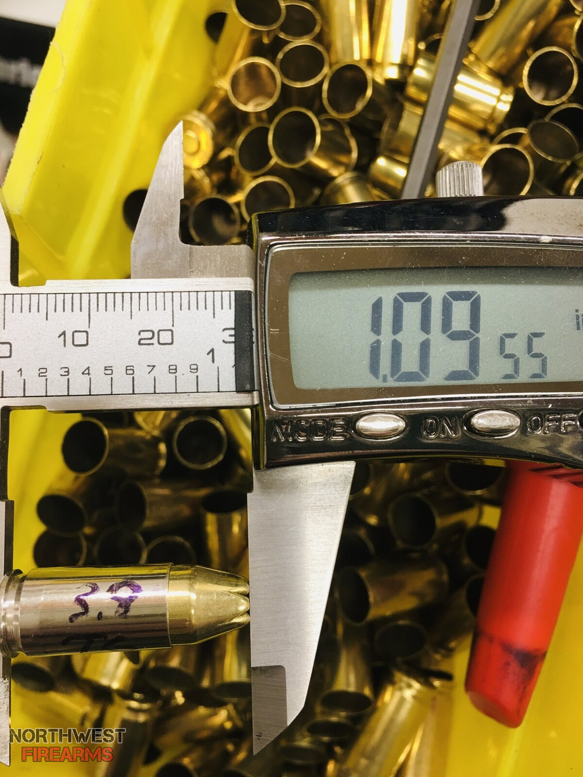

I have a couple hundred that I loaded with brass last year but when I labeled them I forgot to ad the OAL and didn't think to measure until the light went on. :oops: They were 1.090".
