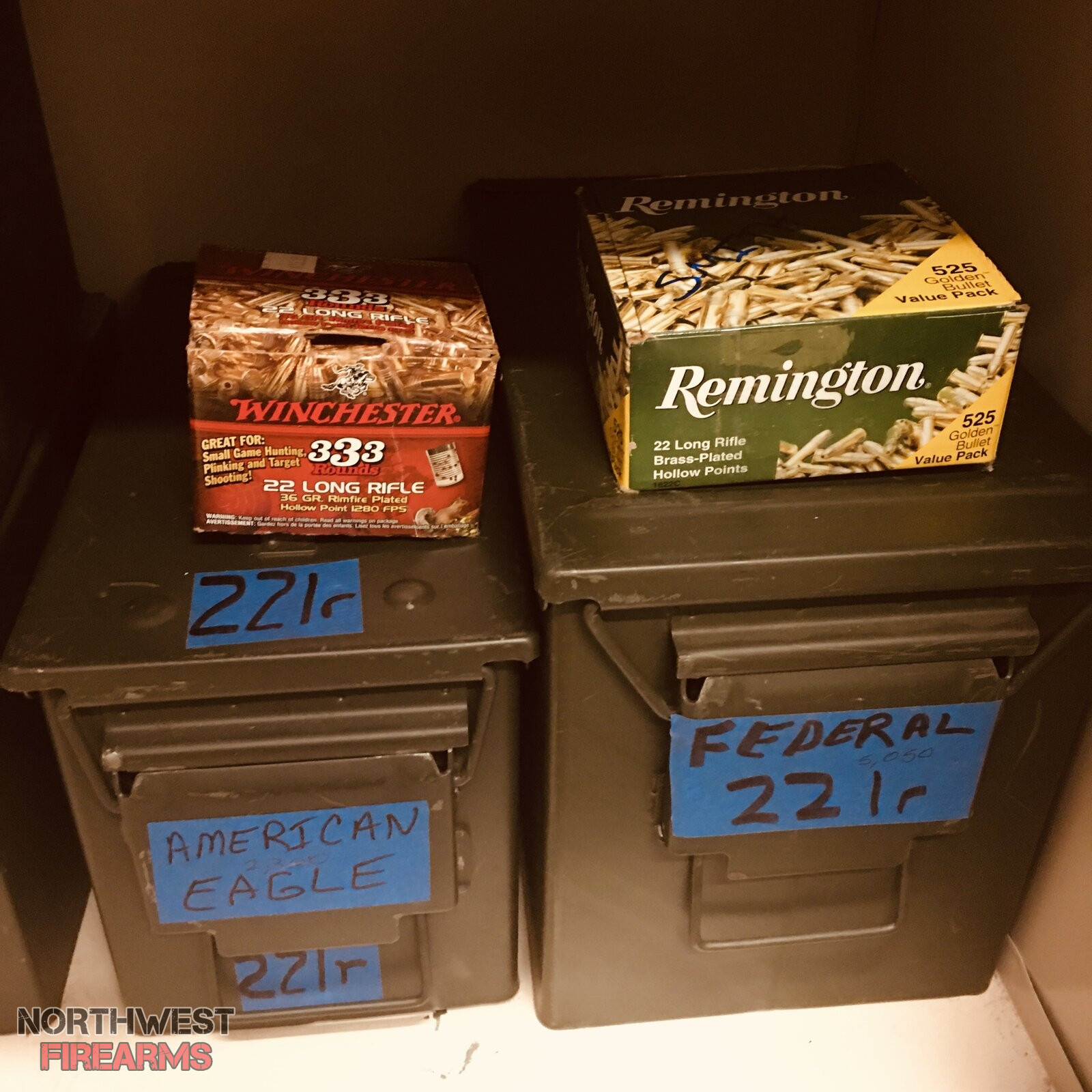

Rimfire ammo, like .22, never seems to be "sealed up" as well as other ammo. Guessing something about the way its made? I have a few times found some that had been forgotten that was decades old and it shot fine in my semi's. Ammo was never left outside or such though. Have shot a LOT of Mil Surp ammo that was FAR older than me and stuff always worked great but, they do seem to seal their stuff real well.
