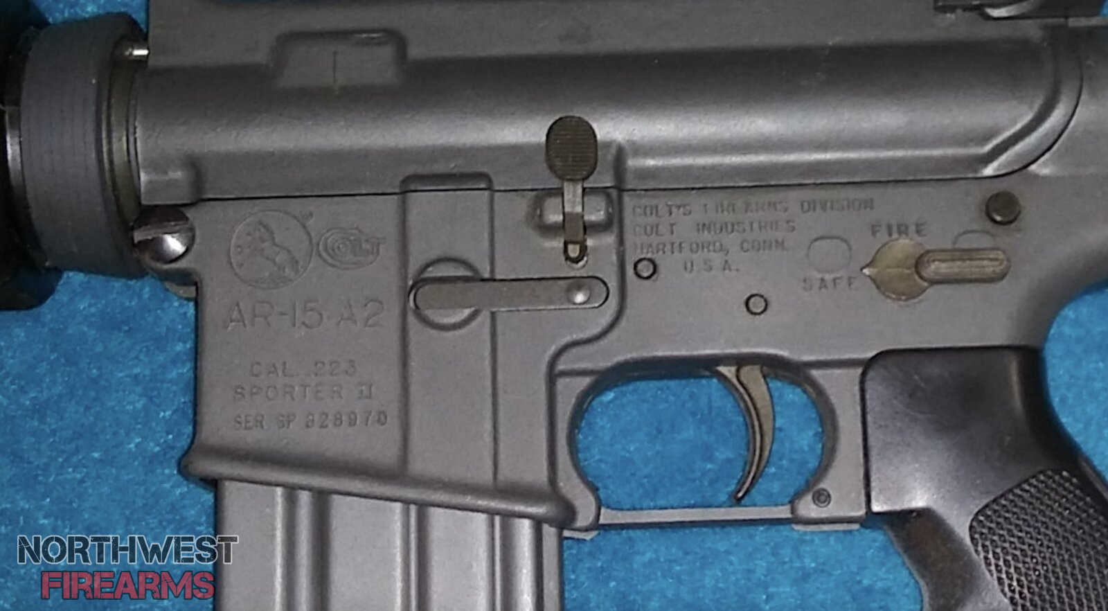

If it says 223, only use 223.
If it says 556, you can use 556 and 223.
If it says 223 wylde, you can use 223 and 556
Although it is true that 5.56x45 NATO fired in a .223REM chamber can be dangerous, it's not because 5.56x45 NATO is a "hot load". It has to do with the bullet being seated into the rifling upon chambering, which can cause chamber pressure to exceed SAAMI limits when fired. Normal cartridge to chamber design allows the bullet to move forward a small distance before entering the rifling when fired, commonly called the "jump". Typically, the greater the jump, the lower the chamber pressure. The jump allows the bullet to gain momentum before entering the rifling, which helps overcome the friction the lands of the rifling imparts on the bullet.
edit:spelling
If it says 223 wyle, you can use 223 and 556
Not a hard and fast rule.

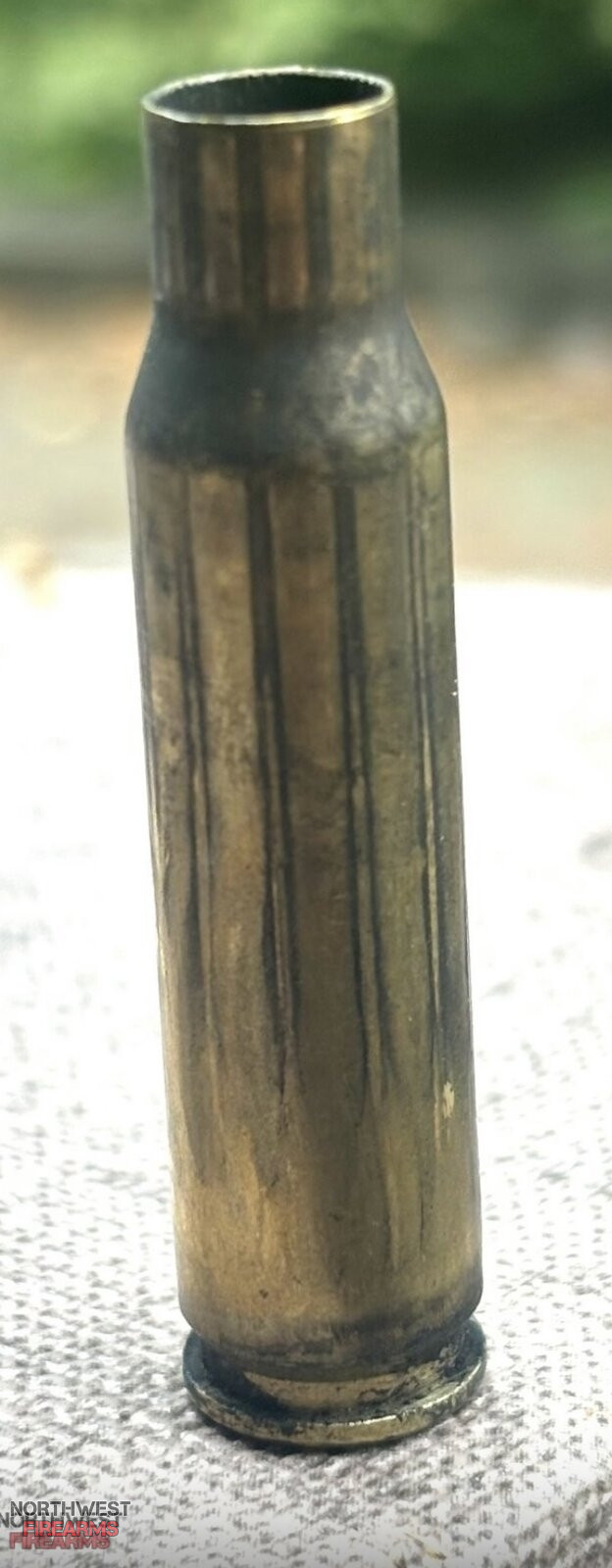

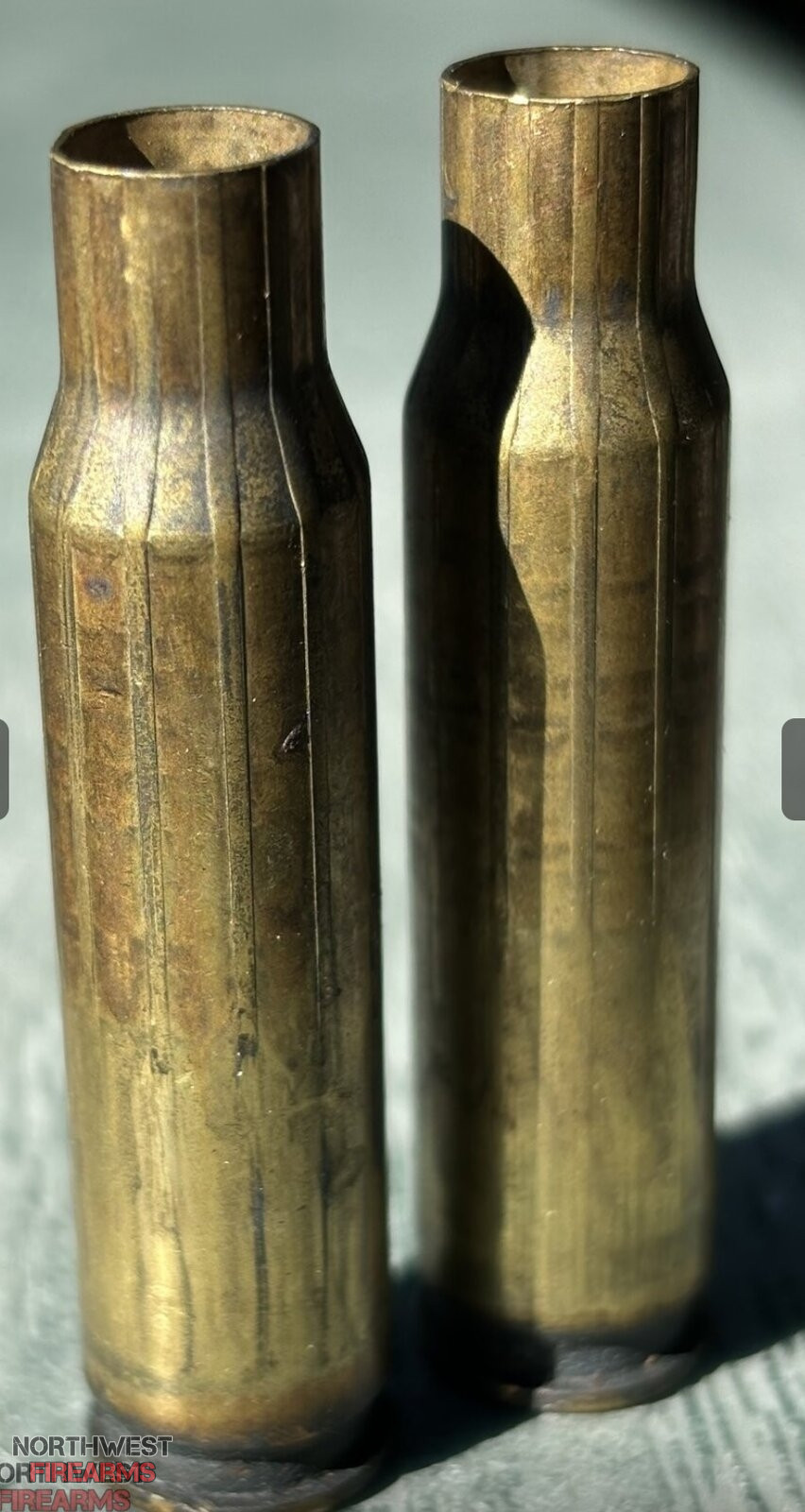

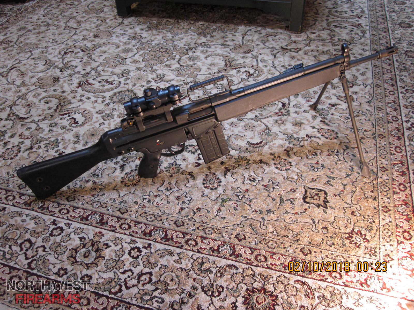

A related note, .308 and 7.62x51 have different case thicknesses. If you shoot .308 in a fluted chamber (such as hk roller delayed firearms have) the .308 brass will extrude into the chamber making the case harder to eject. This can be an issue if you have an hk 91. Sometimes the ejection force can tear the case in half so that half the case remains in the chamber. This won't happen with 7.62x51 because the case is thicker and it doesn't extrude into the flutes.
Now does the same hold true for 5.56 vs .223? Probably, but I've never tried cuz I don't have a 5.56 with flutes chamber. My guess is it will be the same cuz 5.56 brass is thicker. But just a guess. This only applies to fluted chambers. I have heard some people with hk g36 clones have issues if they use .223, likely for this reason.
Many of the hk clones are designed to run with .308 and 7.62x51 but you will have better ejection with 7.62 x 51 cuz it works as designed, the gas in the flutes helps the case eject.
Here is a .308 vs 7.62x 51 in a PTR gun for example. You can see how .308 fills the flutes, defeating the purpose of having the flutes to aid ejection.
.308
7.62x51
