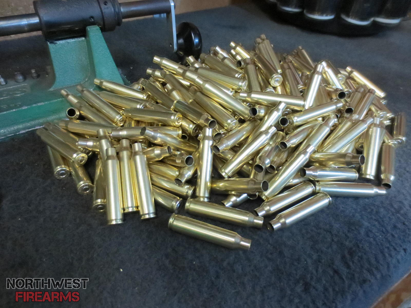

When I went to liquid with pins I never looked back - and wish I had done it earlier. No mess, no fuss and no dust! And my brass has never looked better! This is some old (30ish) Winchester brass that after liquid tumbling and drying took on a very deep yellow/orange patina and didn't change after sitting on my loading desk for several months.

Might have to try the simple green thing. Even after 3 hours with dawn dish soap and lemishine, there's still a tiny bit of crud in the corners of the primer pockets.If you wet tumble...use water, citric acid and dawn soap, with a touch of simple green. Brass will come out factory new.
