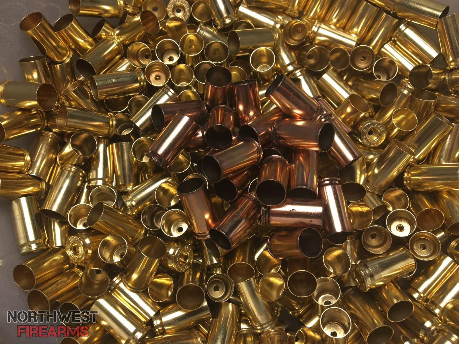

Mine come out spotless when wet tumbling. While clean brass isn't a necessity, it sure does help spot defects and damage to the brass.
I do this process:
for range pickups...
  • Deprime with a universal deprimer die because there could be gunk on the outside and I'm not one to scratch up my dies with debris.
  • Clean with wet media (Frankford Arsenal and wet pins.) I use 1.5oz of Amorall car soap with carnuba wax and the approx of a 9mm case of Lemi-shine.
  • tumble for 90 minutes or more depending on how many pieces are in there or until the brass comes out spotless.
  • Separate the media and brass, dry and then size only to clean again to remove lube.
For brass I've fired already:
  • Lube and size with full length sizer die (i bump shoulder only so it's not much sizing going on)
  • Clean with wet media (Frankford Arsenal and wet pins.) I use 1.5oz of Amorall car soap with carnauba wax and the approx of a 9mm case of Lemi-shine.
  • Trim and put in container marked "ready to load"
I have had no bad results from this process and all brass comes out looking like it came from a new package.
Does it need to be this clean? Not really but I'm a perfectionist.

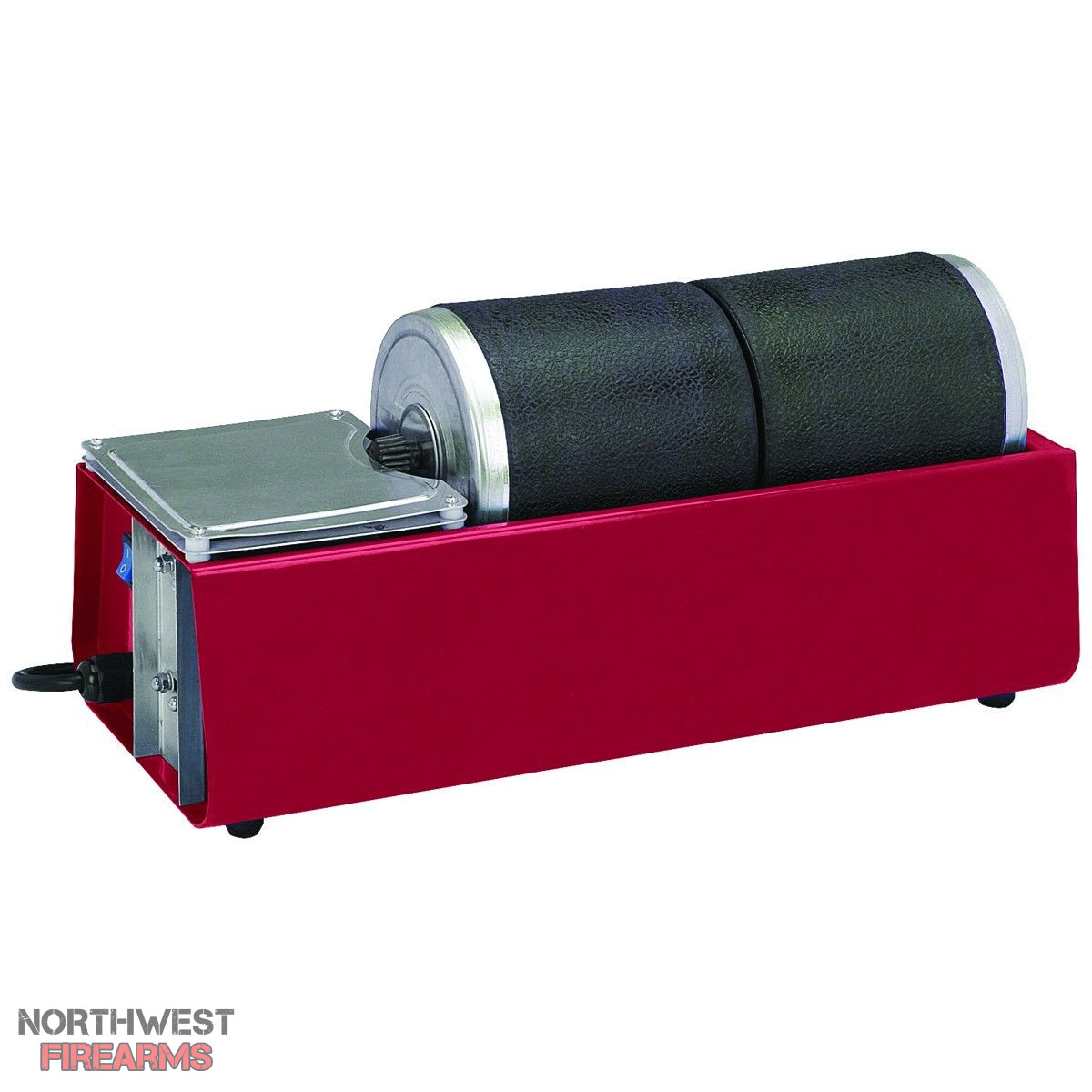

I do have a rock tumbler that is just taking up space on a shelf. Can that be used as a suitable sub? I assume yes, but would like to hear from someone who has tried it (or uses it instead).

Yes, you can use a rock tumbler. When I started out I used this tumbler from Harbor Freight:
Dual Drum Rotary Rock Tumbler
and I still use it for small batches.
