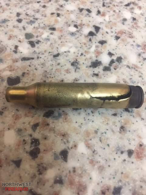

I have two Remington KS rifles and they are a couple of my favorite hunting rifles, one 7mm rem mag and one 270. The rifles are pretty much identical in color and both have Leupold scopes.
Today I was at the range with friends and shooting them both. I chambered and fired a 270 cartridge in the 7mm. I wasn't exactly sure what happened after I fired the rifle. I got a face full of debris and smelled a lot of burned powder. I got a couple of very minor cuts on my forehead that I was unaware of until I asked my friend what my face looked like. It felt like I got sprayed with high velocity sand. I thought I had a case head separation although when I opened the bolt there was nothing. I removed the bolt and could see that the barrel was obstructed. When I got home I ran a rod down the barrel and the 270 case fell out.
Lesson learned, in the future I will only have the ammo on the bench for the firearm that I am shooting. Be careful my friends.
This is the kind of stuff they used to really stress in hunters safety class. Glad to see you are alright. Maybe others that don't know, can learn from your mishap and never do what you did... Good lesson learned i'm sure..
