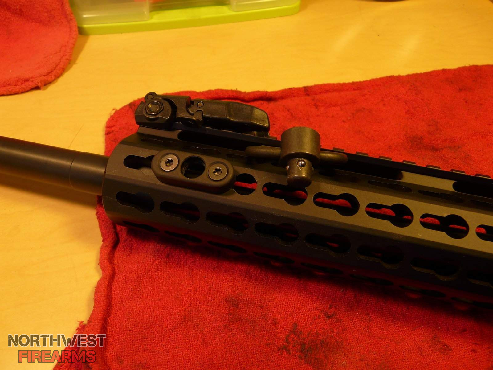

I purchased a rifle from Curt's with the key-mod hand guard. Small diameter and not "Cheese Grater". Very comfortable. The problem is I went to attach sling with a Troy swivel. The key-mod mount went on the rail fine, but the swivel piece wont go in the mount all the way because the hole in the rail is too small.
Question: Are there two sizes quick release swivel mounts? Or is it as @dwaineshort says above, and I'm screwed and needing to buy another rail?

The photo shows the rail mount in place. The sling swivel need to go into the mount and protrude through the rail slightly. The holes in the hand guard are, barely, too small for that.

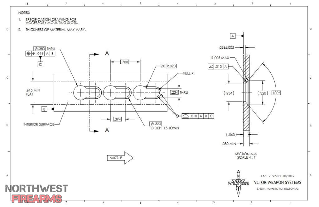

That's the exact problem I have as well. Bought the gun (Stag) new from LGS. Bought a keymod QD fitting so I could have a sling mount. QD fitting would not go in. Posted a question on the local gun board here in PA and somebody suggested a deeper profile adapter (already defeating the sleek low profile benefit). Got the same answer from Stag. OK. I find one on Amazon and order up. Came in, looks great, the entire QD barrel can fit without needing to go through the keymod. Except...
The new adapter has a "lock ring" that needs to fit into the keymod. Now I really start doing my homework. I find the keymod specs in a technical drawing. The round part of the hole is supposed to be .380". QD posts are supposed to be .375". The holes on my Diamondhead keymod are .348", maybe .350" if you scraped all the finish off. Maybe I could hammer it in?

Not that I have found, anyway. The keymod, like other forms of standardization, is supposed to be just that, a standard. It was invented by VLTOR and the standards were published for others to use. I will try to attach a drawing...
