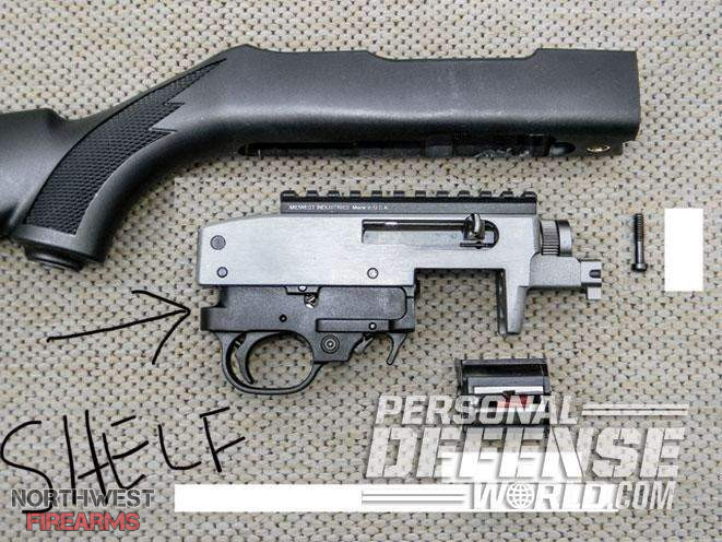

There is a shelf in the stock of all 10-22s that slides into a groove on the receiver and trigger pack as it is seated at the rear tang portion.
This can be very tight on some stocks and less tight on others.
The receiver needs to travel forward of the stock as it is lifted upwards. Lifting only upward will not work so well on a tight stock.
Perhaps a friendly tap from a mallet on the front of the stock rearward as you are pulling up and forward with the barreled action will assist.
Picture of area in reference.
