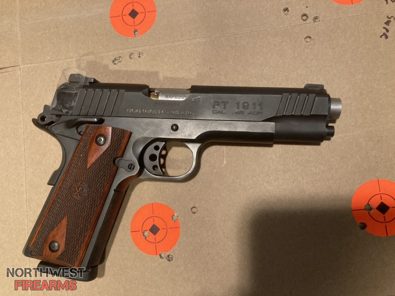

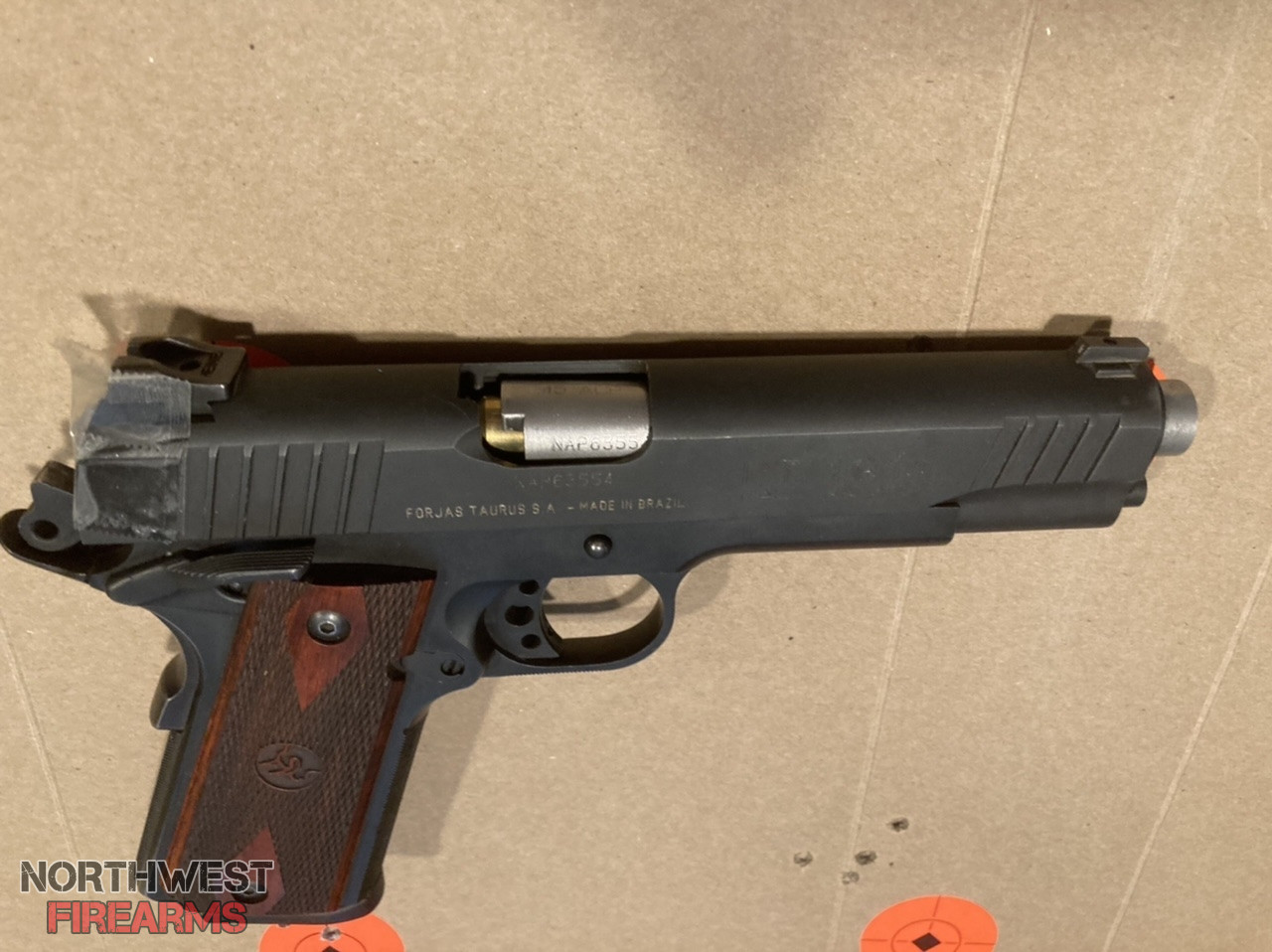

Here are a couple pics of current condition.:
49AD20A1-8CF6-4E18-B215-2D82290CD09F.jpeg D85EA46E-83A8-45EE-BD8C-3D0E6197A969.jpeg
View attachment 1235456 View attachment 1235457
When I hold my slide open about the same amount, I see a noticable tilt in the hood part of the barrel. In your first pic, the barrel looks fairly straight with the slide. I wonder if you took a plastic mallot or piece of wood and gently tapped down on the top of the barrel hood to see if it frees things up. Note: Im not a gunsmith... though just genuinely curious what would be the cause of your jam?
Correct. My son even hammered on it a little with a piece of wood and it doesn't seem to budge.
I believe that won't do what you need - as others have suggested, you need it on the edge of a hard surface, though there is plenty of room above the muzzle to do this rather than needing to use the rear sights.
