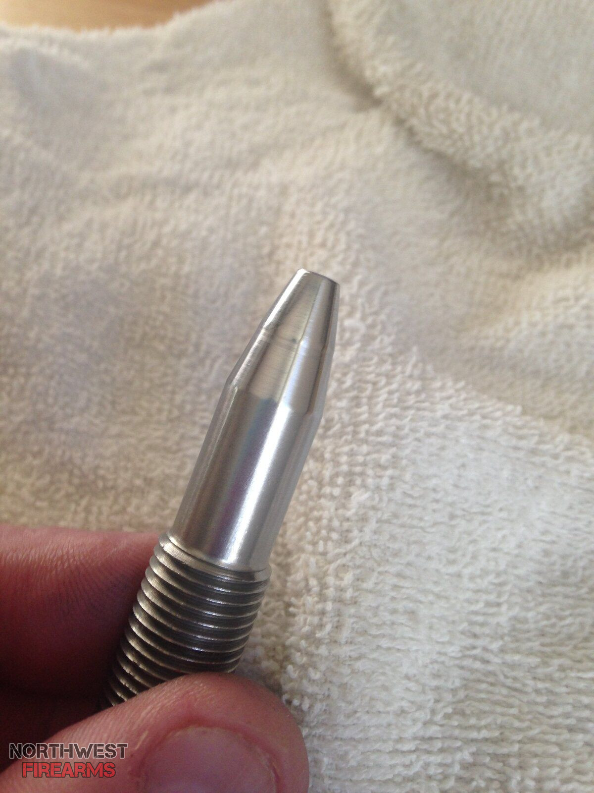

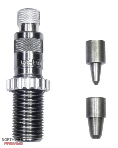

Yes I'm aware of the inside chamfer. I like to keep this as minimal as possible. Would this Lee die serve this purpose?
You could try that as well. Just make sure to close the mouth back up after seating the bullet.

Yes, the Lee expander pinned above is recommended for cast projectiles.

When loading 300 BLK subsonic, I have used a hi tek coated, flat base 220 grain bullet. After initially having difficulty seating these bullets in sized or new cases, I use the Lee universal expanding die you linked to slightly flare the case mouth. After seating with my Forster seating die (with the floating chamber), I use the Lee FCD to remove the slight bell/flare. This process has worked well for me in this application with coated lead, flat base bullets that are probably on the larger diameter for the expander on the sizer die that were difficult to seat without shaving the coating/lead on a sized case.
