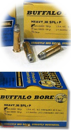

You may want to check these out.
Those are great and likely work well. Being Buffalo Bore I would feel better about shooting them out of a .357. My experience with Buffalo Bore is that they run on the lunatic fringe of hot. Nothing wrong with that but I wouldn't like to run them through my elderly model 36. My 66-0, 27-2, or my sp 101? Sure. Not sure I would run those in my old Colt .38 detective special either. Hmm. Maybe. The 64 that the OP has is a .38 but it is a K frame so...maybe? Probably okay in a K frame .38. I tend to be more cautious with my old Smiths because they kind of a work of functional art. Plus they are just purrty :p
