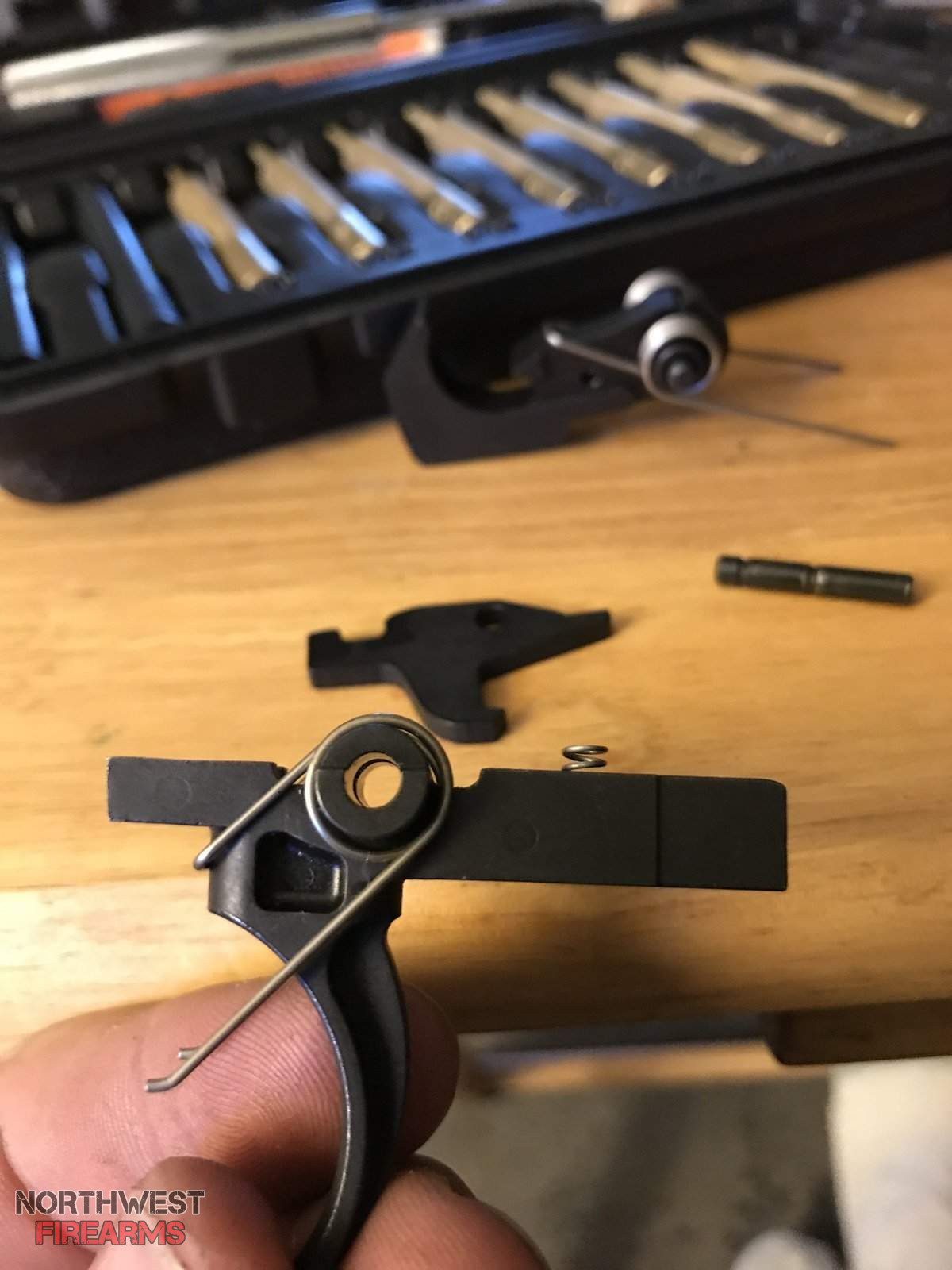

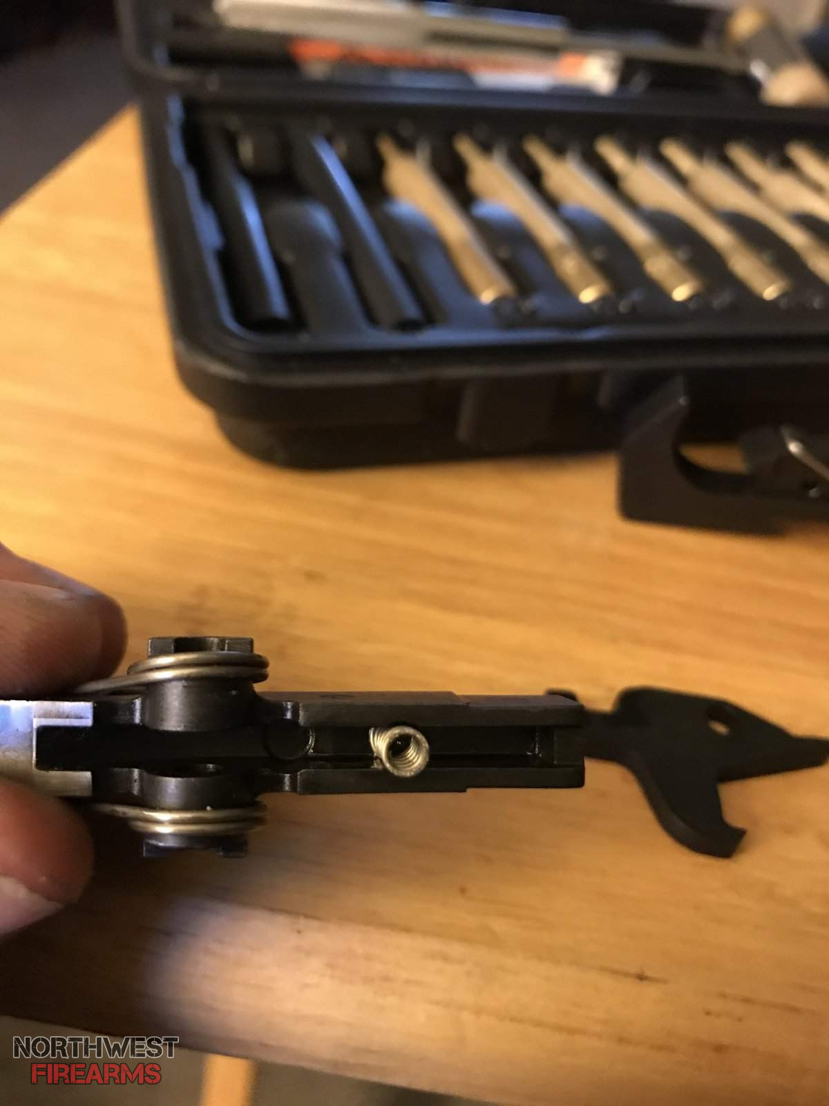

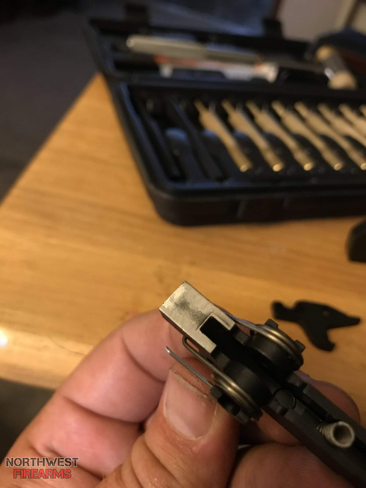

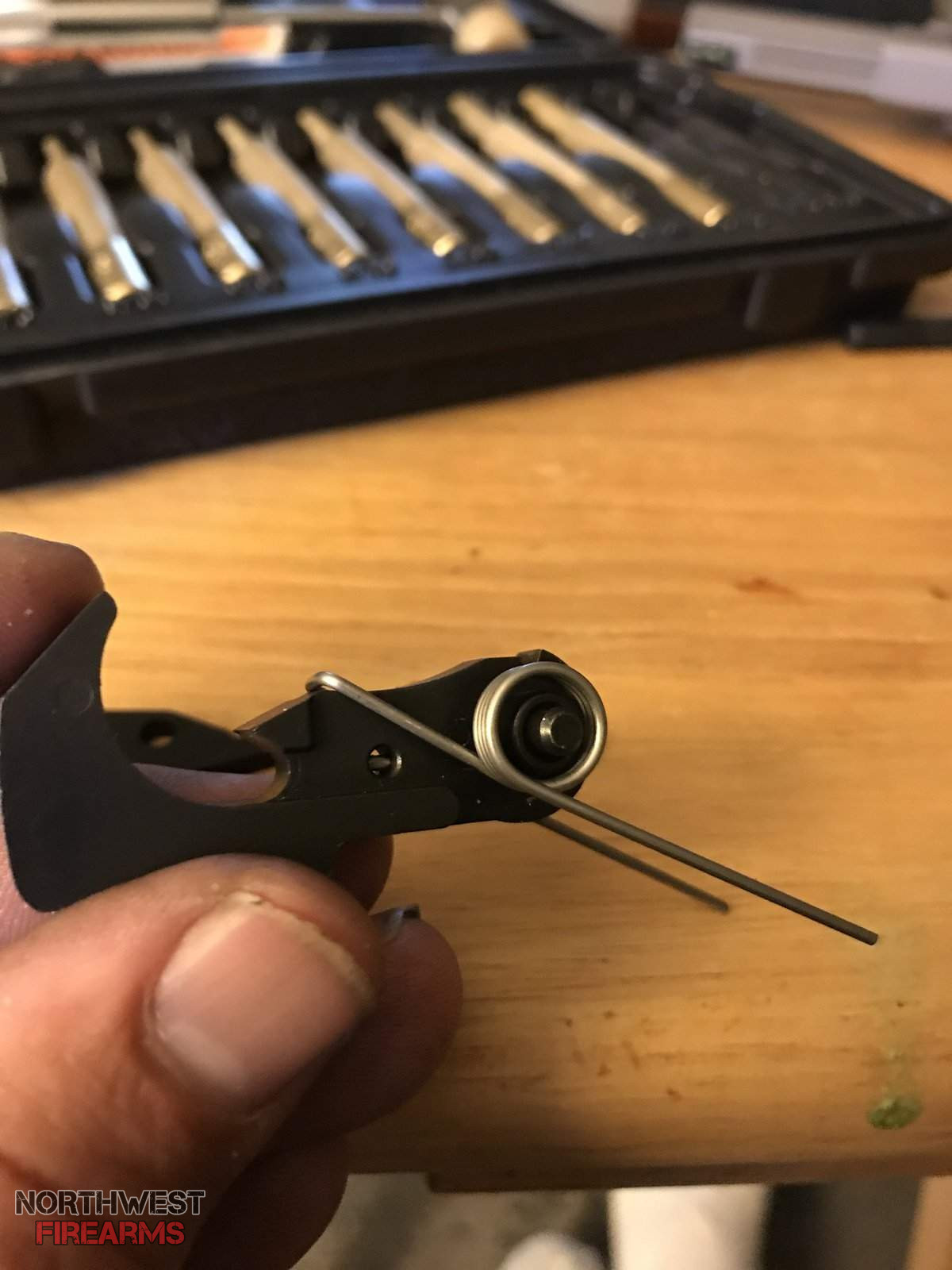

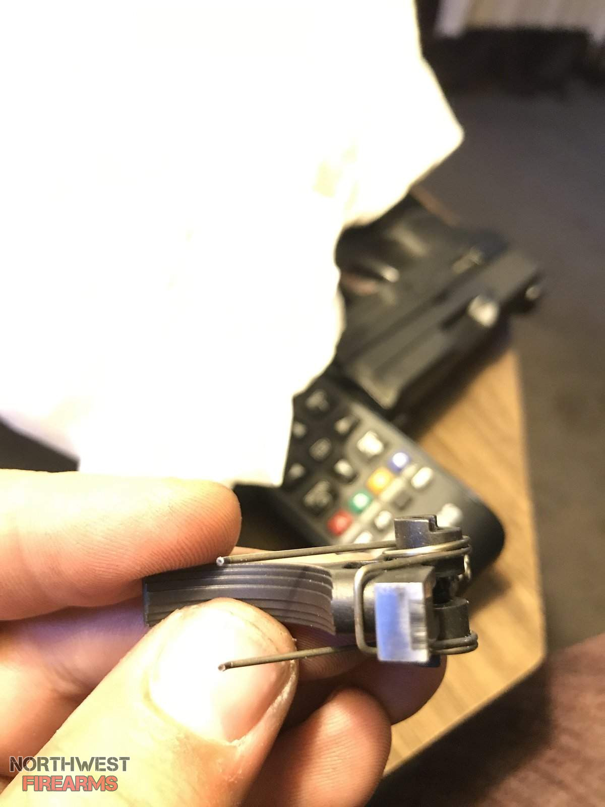

i didn't read all the posts so this might have been mentioned but my friend had this problem and I fixed it for him, he installed the small disconnector spring in his trigger pack upside down, i assessed the problem and switched it and it ran 100%
Are you certain that the hole in the gas block is aligned with the gas port on the barrel? Failure to function is likely a gas issue. Failing that, I would try a different magazine.
Multiple magazines have been tried. All work perfectly fine in other rifles. The upper is from a different rifle that has zero issues.
I am going to triple check again the disconnector spring. All of it is installed correctly but just because I checked maybe I missed something. Doubt it but it is worth checking.
Replaced the FCG with the one that @bolus sent. Have to see what happens when I go shooting. Btw, the disconnector spring is face down/ large size is down. image.jpg image.jpg image.jpg image.jpg image.jpg Nothing looks out of the ordinary either. These are pictures of the FCG that was in the lower.

There is no cycling problem, the weapon fired, the BCG extracted & ejected the spent round and stripped a new round from the magazine into the barrel extension, just like it suppose to. The issue is an out of spec FCG or lower receiver.
