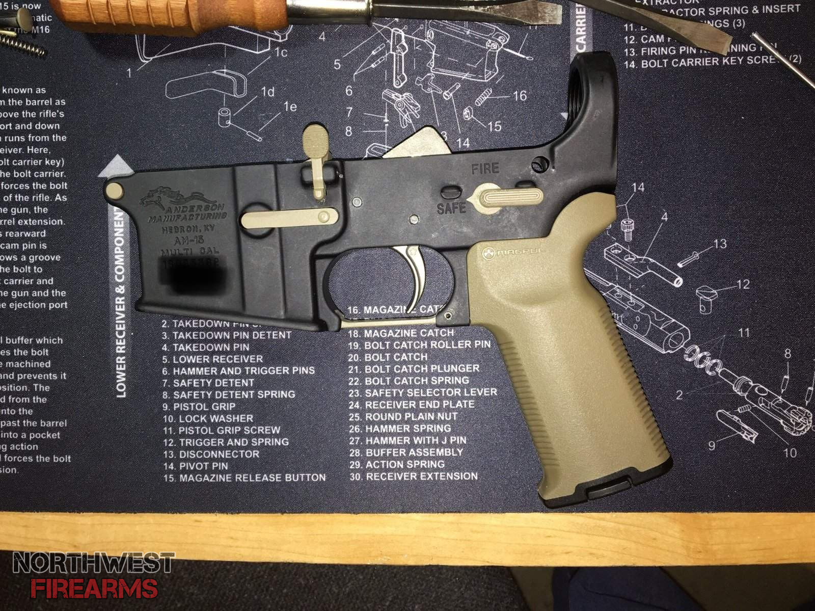

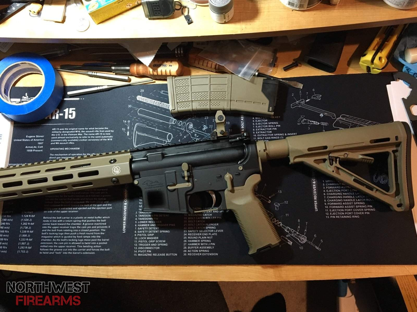

I am done assembling my lower. Not cheap given I bought a BCM PNT trigger assembly. Turned out very nice. Just need a sling and a sling mount. Maybe a single point sling instead for this.
I had the buffer spring detent fly away from me but I keep a few spares so just dug into my backup parts.
The only issue I had was the hammer part of the trigger. I had to get my vise out and use the vise block to drive the roll pin in completely. I drove the pin about 3/4 of the way but could not hold the hammer and align the hammer without a vise block.

Not to sound like a jerk but to me, if an AR has issues from the time its built then something is wrong. I've never believed in "break in periods." One or more components may be responsible but they should be replaced. It should 100% function all of the time.
Installing the pesky hammer and trigger pins can be tricky. Another pesky pin to install is the bolt stop assembly roll pin. Both take some fiddling to do. It takes practice and experience to line up all the parts using your fingers, then tapping in the roll pin or the hammer and trigger pins. If everything is aligned properly the pins go in easily.
As far as the buffer stop assembly, along with the take down detents, consider a thin reusable dry cleaning sack as an overall containing bag. Amazing hang times with the many small dinky pesky detents, springs and small parts. Lost in the shag carpet forever. Even the cat can't find them. Even I kept many spares. I needed them. Yikes!

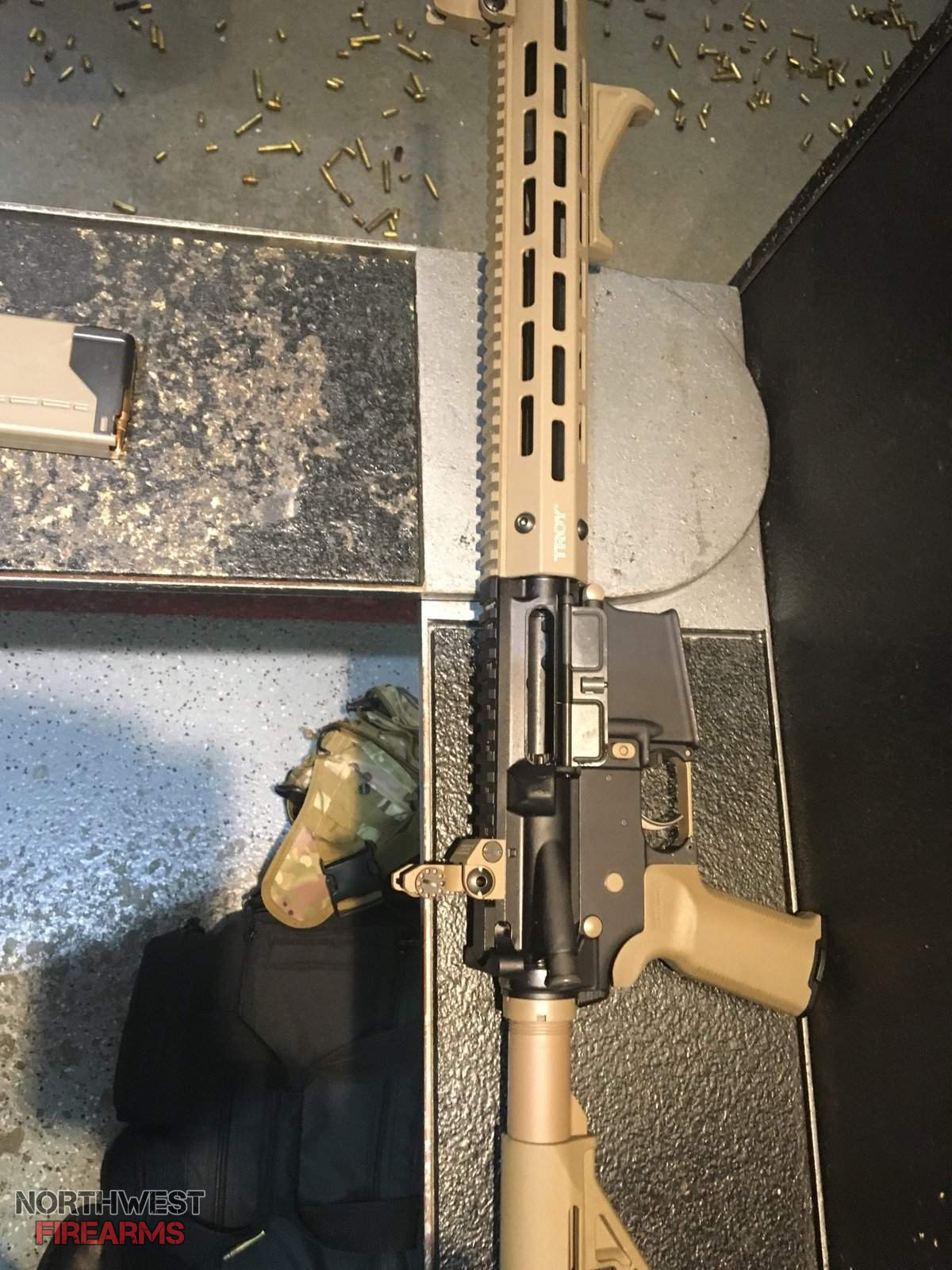

I took my FDE build to the range yesterday and put 90 rounds through. Put the target out at 15 yards.
First shot was low. :(
I had issues with my second lower but took the Magpul BAD lever off and will take my second lower to the range probably next week. The bolt kept locking back for every round. Look at Gunsmith Forum.
