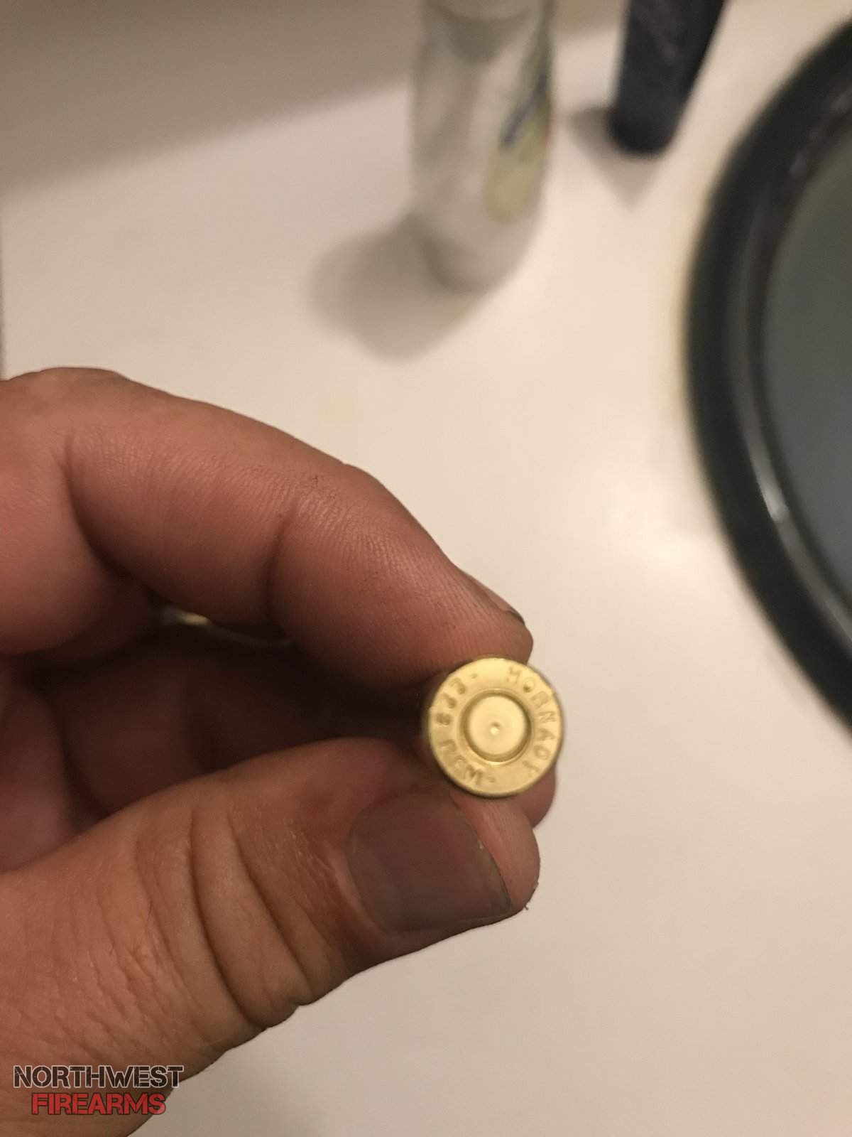

B1E6A2FD-8AF5-4F4A-8851-85CAF17CC0DC.jpeg Normal match grade ammunition that I use! ;)

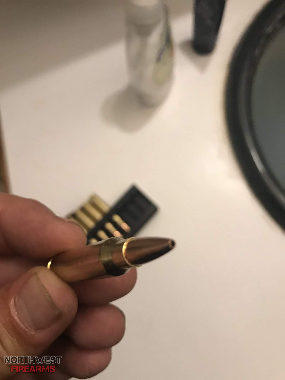

6CA279BD-FA2B-4FDB-AD1A-12F9C7D9185E.jpeg What is used in the video.:)
