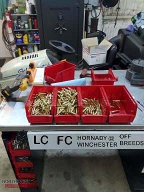

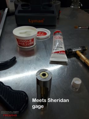

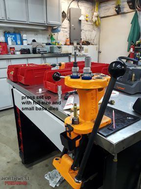

How are the primer pockets?Time for an update (such as it is). Lubed cases using the alcohol and lanolin mix many of us use. Readjusted my dies this morning, sorted cases by headstamps, took a few pics and here we go. Took the Hornady and Winchester cases thru the full size dies without any problems. I double struck them, rotating the case about 180 degrees for the second stroke.
I ran about ten of cases marked LC thru the full size dies again double striking. Some passed the Sheridan gage headspace. The 2 or 3 that did not drop into the gage I moved to the small base die and restruck them. They did drop into the gage after this.

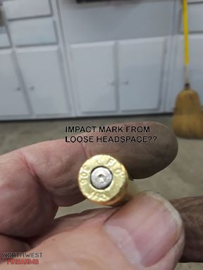

I did notice some of the FC cases were marked up on the base and I presume this was from a loose headspace and the bolt marked them. This was likely thru a machine gun that needed some attention.

View attachment 823589 View attachment 823591 View attachment 823593 View attachment 823594

Sounds like your primer pockets are fine which would rule out over pressure hot loads. As for the military brass hanging up on the rim, that adds to the suspicion that it was fired in an automatic or semi auto weapon. They frequently chew up the rims of the cases. This is when you need to check them in your rifle to see if they reliably chamber fully. If they don't, then you might be able to file the offending burrs or scrap them to the local recycler and chalk it up to experience. I count myself fortunate that my PA-10 .308 AR is kind to my brass, and once resized, they fully enter my Lyman gauge.Pretty frustrating day really. Question asked yesterday about primer pockets. The LC brass is military crimped and meets a Ballistic Tools go/no go gage after decrimping. FC marked brass is NOT crimped and meets the gage w/ easy insertion and the no go gage will not fit in.
