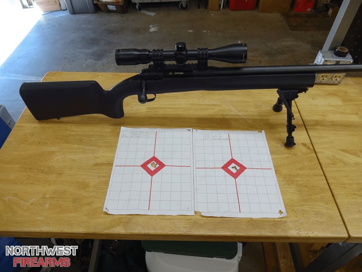

I am going to have to dump this 308 Savage now.:(:( Maybe I can get $100 for it???I didn't know 6.5 BleedMore RULES.:D
5 shot groups at 100 yards
