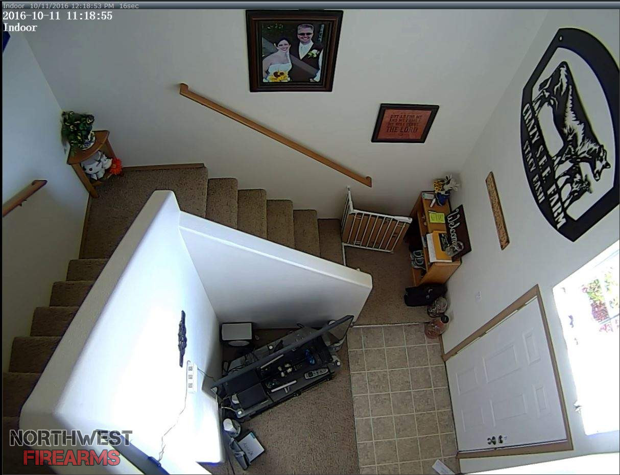

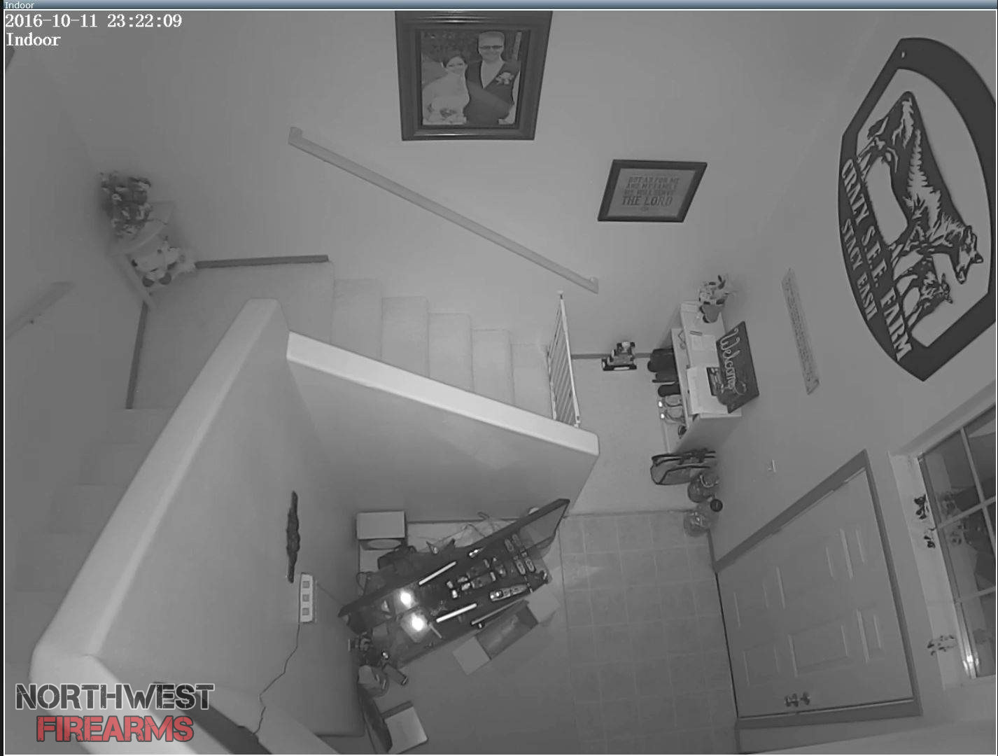

Foscam FI9831PB - Recently picked this camera up as a replacement to the one I had in the house, it makes quite a difference over the older camera I had, this is a 960p camera and does quite well in the house, I attached two photos from this cam, one right now at midnight, no lights on and the other is mid-day.
https://www.amazon.com/Foscam-FI983...ie=UTF8&qid=1476256815&sr=1-4&keywords=foscam
This camera is pretty close to my router and so I get roughly 15fps out of it and no bandwidth issues at all, I had a cheaper outdoor camera which is out of service right now (I broke the mount) which I had sitting out in front of the cars, It worked ok but it would drop signal regularly, It was mounted outside of the house with WIFI and would drop constantly.
