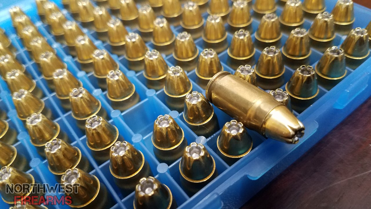

And for lesser popular calibers like the 357sig, factory hollow point bullets average about $1.60 CPR. I love my 357sig and I reload hollow points for about 23 CPR, less if I'm not using new brass.
I love my 357sig (G32) because it's identical in size to my G19. I push a125gr projectile at close to 1,500fps. This beats the heck out of using my G20 (10mm) for EDC.
All it takes to make a HP from a FMJ is a wee careful touch (not too deep!) with a drill press and a proper size bit.
