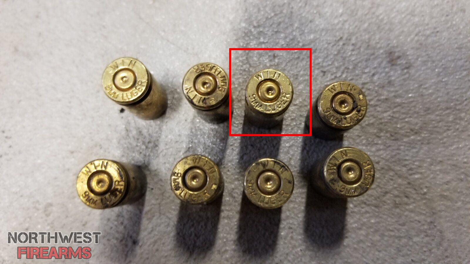

This primer looks weird to me. It seems oddly bulged out -- like it was just about to erupt and let gas out the wrong way, but also not flattened -- could the case have been stuck too far in the chamber? Is that even a possibility?
Looking through my brass piles, my own reloads and range pickups, I would say the amount of soot on the case head is weird too. As if gas was leaking. I don't have a shield so maybe that's normal, but these cases look amazingly filthy. In the picture I quoted above, only the upper left and the one I quoted with the red box look like the right amount of soot to me.
Good point! I thought they looked very dirty also
9mm headspace son the case mouth. You could get a weird looking primer like that if the case length was too short
That's interesting -- I wonder if the OP has the tools to take a cartridge apart and measure the case length.
Another bit that might support that idea, is that the upper left case in the pic I quoted appears to have a lighter primer strike than the others in the group. If it was farther forward, the firing pin wouldn't make as much of a dent.

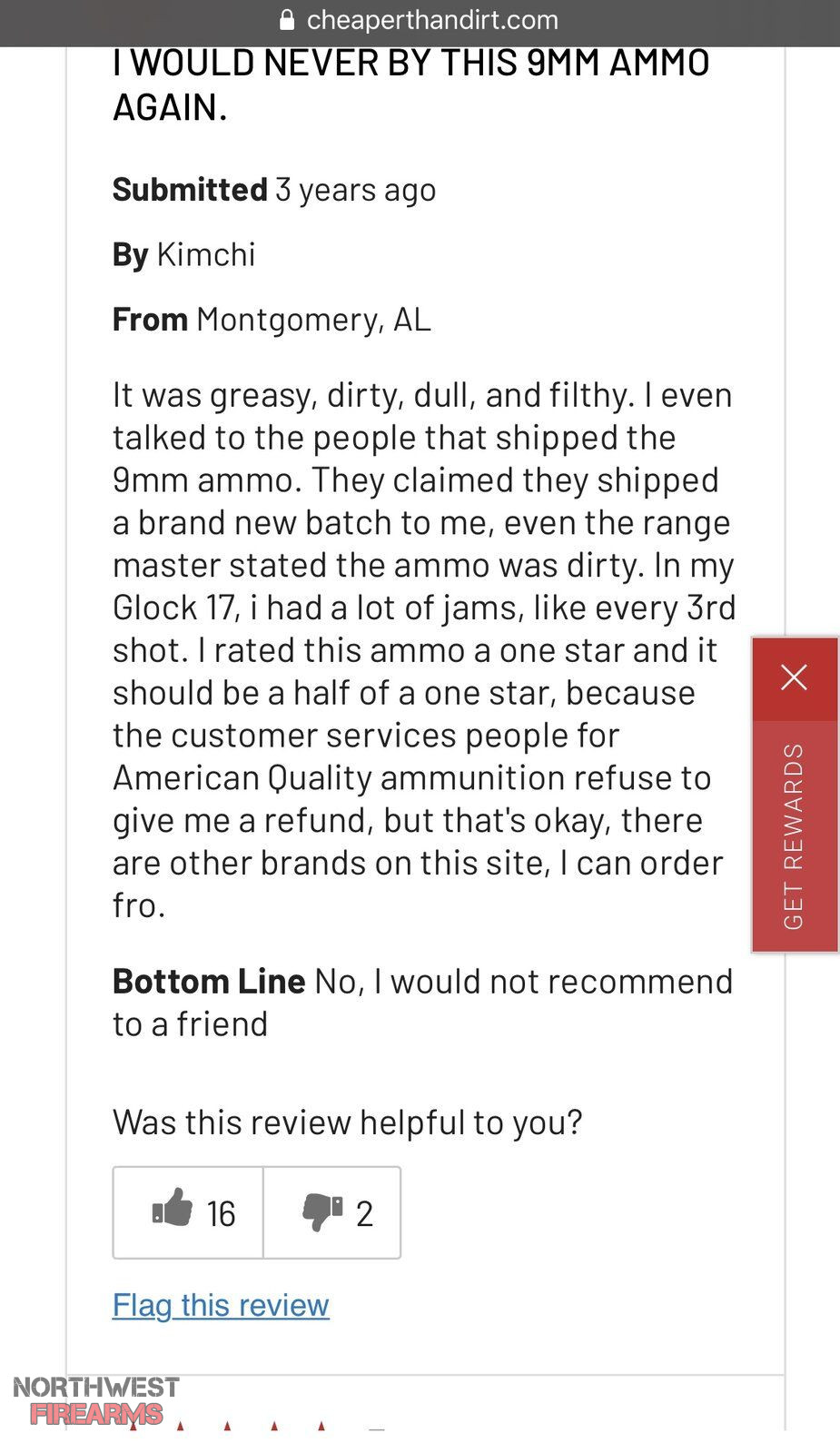

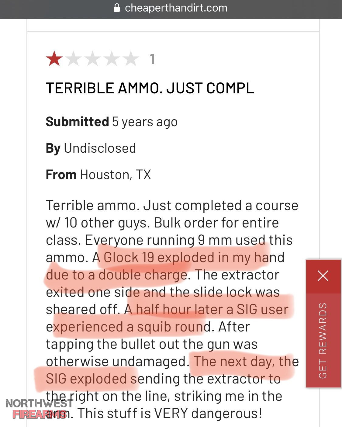

Fwiw looking at the first page of cheaper than dirt reviews on this ammo, some love it and some really hate it. Sounds like a lot of variability with this ammo from the few reviews that I read. A couple of the bad reviews on page 1 of the reviews listed below FYI:
Also I noticed this one when cherry picking for only the bad reviews (Again, fwiw, there are lots of good reviews also)
In the first photo the bottom four cases look to me to be showing early signs of primer cratering. If this is the case it's a potential sign of over pressure.
I'm with those here that think the amount of soot on the cases is strange.
Any time a company feels the need to add "Quality" to its name is probably a bad sign. Looks like people are having a hard time finding the company contact info too.

Lots of soot. Lots.
Some of those primers look cratered and bulged - but no flattening... (loose headspace?)
Have you measured the spent casings legnth yet?
Hot loads on short used casings...?
