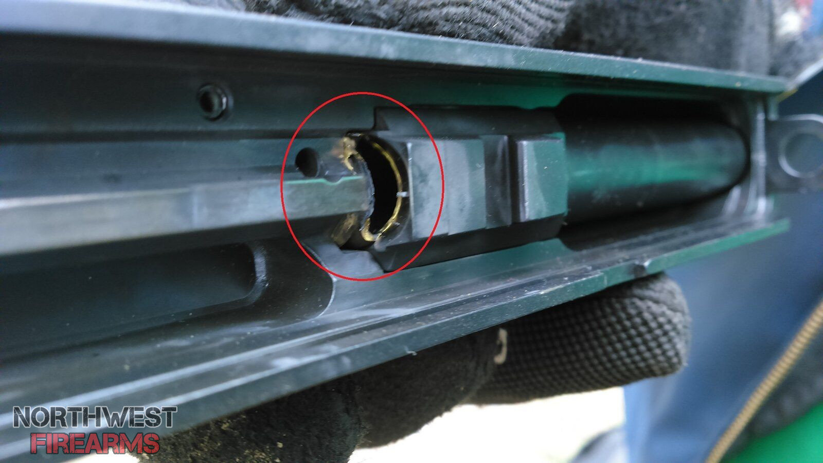

Are you sure the barrel is clear of obstructions? If so am I seeing the case stuck in the chamber with a large hole blown out the rear?
If so that is a situation where the pressure spike was so fast and so over limits that it pinned the case against the chamber walls and blew out the bottom of the primer pocket.

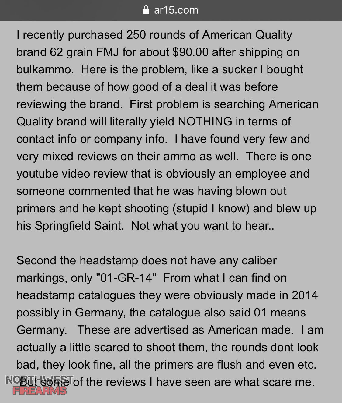

"American Quality Ammunition" is apparently the brand name. There are comments here and there about it online. Cheaper than Dirt sells it. Some comments that this is probably reloaded ammo. Some of their .223 is loaded in LC cartridge cases. Some mention of very dirty burning powder in their .223.
I read the same comment on another web site that was posted in #6, above. That part about, that you can't find any contact info for the maker of this ammo. That isn't encouraging. You'd think that any legitimate firm would put an address on the box.
It's funny that on Cheaper than Dirt's website, there are zero reviews left for it.

With my USP(.45ACP), it was locked in battery & stayed that way. Completely locked. You can see where the case blew out, right where it wasn't supported. I won't disclose the name of the company, because 1) They were very professional every step of the way(also replaced my gun) & 2) I'm of the impression that these things could happen to almost any ammo manufacturers.
I also contacted Heckler & Koch, they blamed the ammo manufacturer immediately. Most people I showed it to leaned towards ammo issue, but there were couple who weren't 100%. Ammo company had me return the entire batch back to them(few boxes), especially interested in the very box the particular ammo came in. They tested it, said couldn't find anything wrong with it, but would send me another USP.

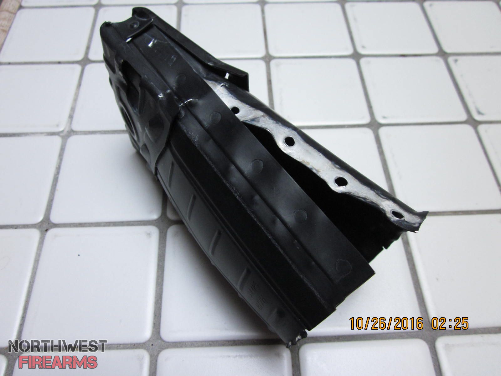

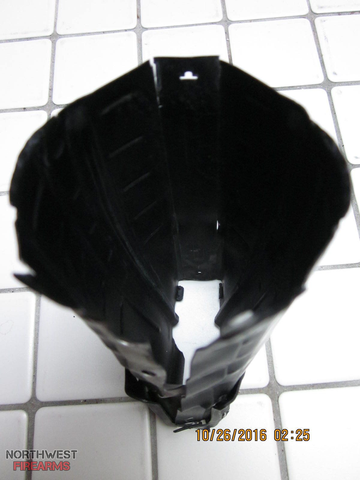

Had a case head blow out on an HK91 decades ago. Blew the magazine floorplate, spring and follower plus a few rounds into my leg (sore but no blood). Bulged the sides of the receiver. Still have the mag, but the guys who sold me the ammo paid for the 91. That was a looooong time ago.
EDIT: Found the pics. HK uses both steel and aluminum mags. Very lucky that this was an alloy mag.
