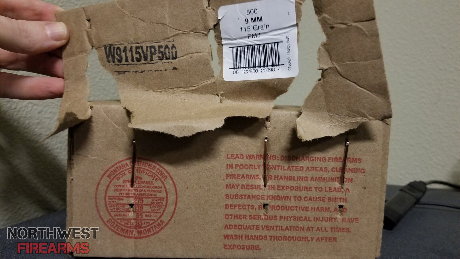

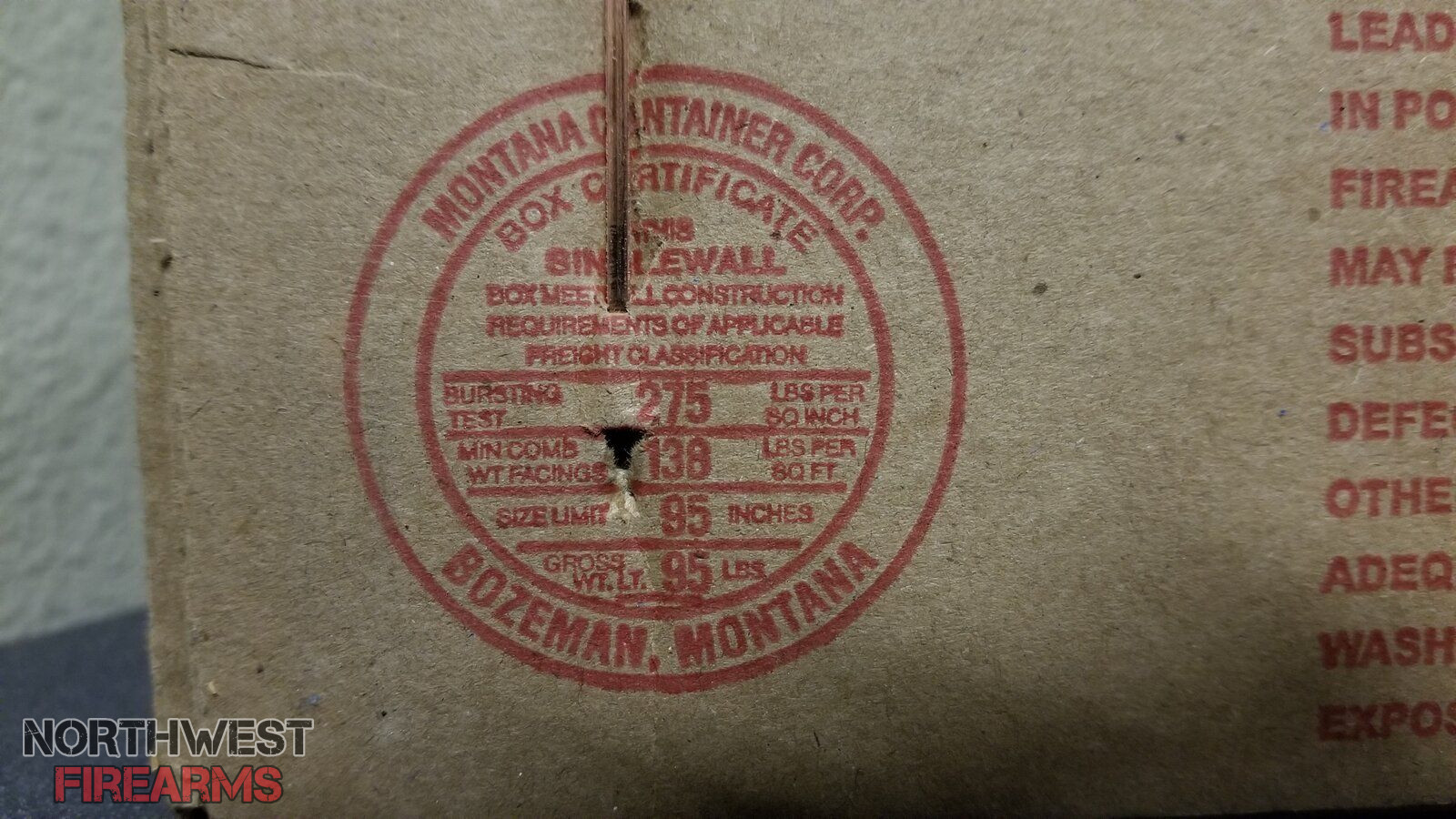

Only other markings on the box.
So off that item bar code, the first 6 digits are the manufacturing id as registered with The Uniform Code Council. Should be able to use that to track down who manufactured the ammo, that is unless it was applied by Cheaper than Dirt, then all bets are off...
I checked a barcode database for several of their products as listed on the CTD website previously -- found a box of Nosler bullets I have on my shelf, but nothing for AQA. Nada.
