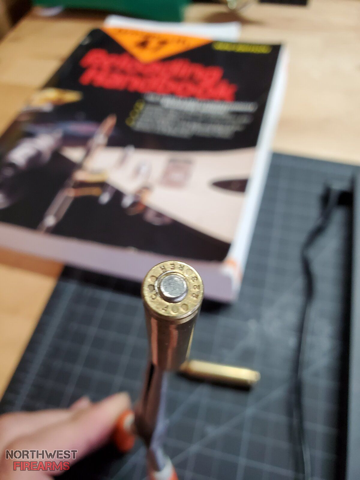

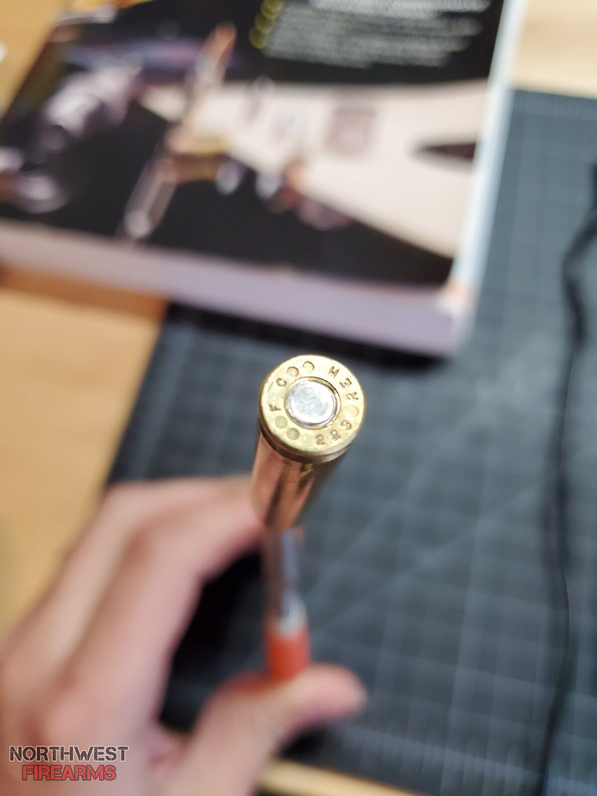

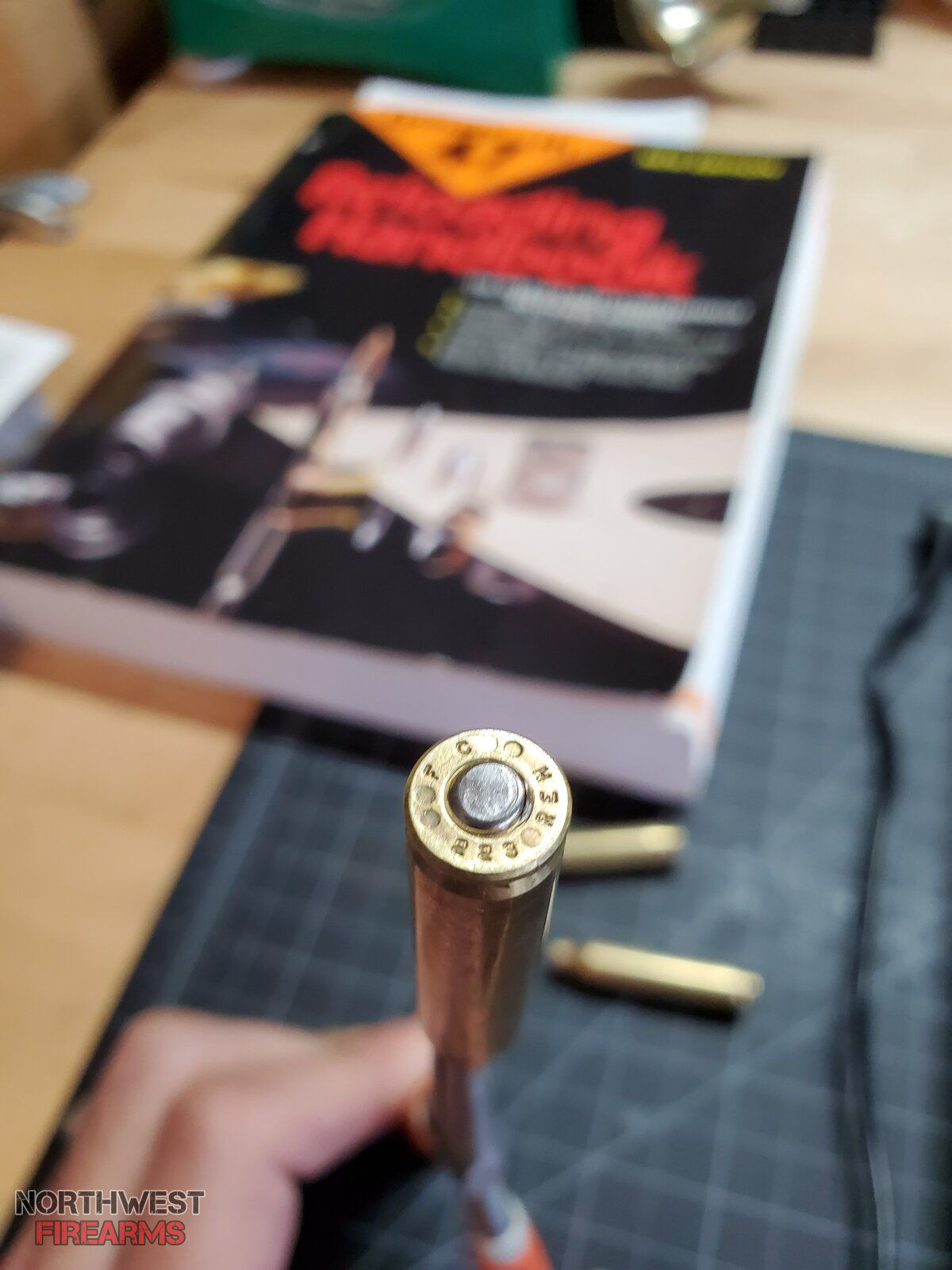

Do you guys that reload 223 uniform every pocket?
I've reloading a few thousand 223 but this weekend I started having trouble seating primers. It would happen probably 1 in every 25 rounds.
Each case was tumbled and the primer pocket cleaned before attempting to seat using a rock chucker.
I've never done more than scrub out the primer pockets with the rcbs brush tool, so this is new to me. But if it'd save this from happening I'll start looking for the tool.

5.56 brass loaded to military specifications has a crimped in primer. There are a number of tools available to remove this crimp, I can give you a rundown if you need this info. You can see the indentations from the crimping process on the rim of the primer pockets you show in your post.
You only need to remove the crimp one time.
Let us know if you want a rundown on the ways to handle this, it basically comes down to trimming, reaming or swaging.

Sorry to be that guy, but every picture you showed has a crimped pocket. That "ring" embossed around the primer is from the crimping process.
personally I use the frankford swage tool for all my 223-556 brass to uniform the primer pockets and keep things feeding smoothly.
you will absolutely have issues with the LC brass if you attempt to seat primers, they are all crimped without exception

@Red98422 is spot on. All your pics showed crimps. Those crimps need to be removed or you will continue to ruin primers, not to mention really stress your priming tools.
I highly recommend one of these:
It's a primer pocket go / no go gauge that saves untold amounts of grief. Get the combo pack with both large and small pocket tool as well as the case neck tension gauge.

I used to remove crimps with an RCBS deburring tool chucked in a drill press. Just slightly bevel the pocket for slick primer insertion. I then got a reamer attachment for my Lyman case trimmer. Faster and easier on the fingers rather than holding onto brass as the deburring tool spins in the drill press. Then I got the Dillon Super Swage ... faster yet and easier on the hands. Now I have a swage that attaches to my 550 press that allows me to have a tool head that decaps, swages, sizes, trims and tensions the case mouth progressively.
All methods work and work well. It's all a matter of how many cases are you working with and how much do you value your time.

Swage = "Squishing" the primer opening to the correct size, but the "crimp" ring is not removed.
Cutting, various methods = Cutting the crimp out, or removing a portion of it.
You will see people debate on which one works best for them. I have tried the Dillon Swager and RCBS cutter in a prep center.
I find overall with the Dillon I had less errors and it went faster. The cutter looks cleaner but is slower and I found I removed too much material often.
I would say you choice probably comes down to how many you have to do, how efficiently you want to do them and what your level of attention to detail is.

Those FC .223 cases need to have the crimp swaged or cut from the primer pockets.
Ask me how I know...:eek:
