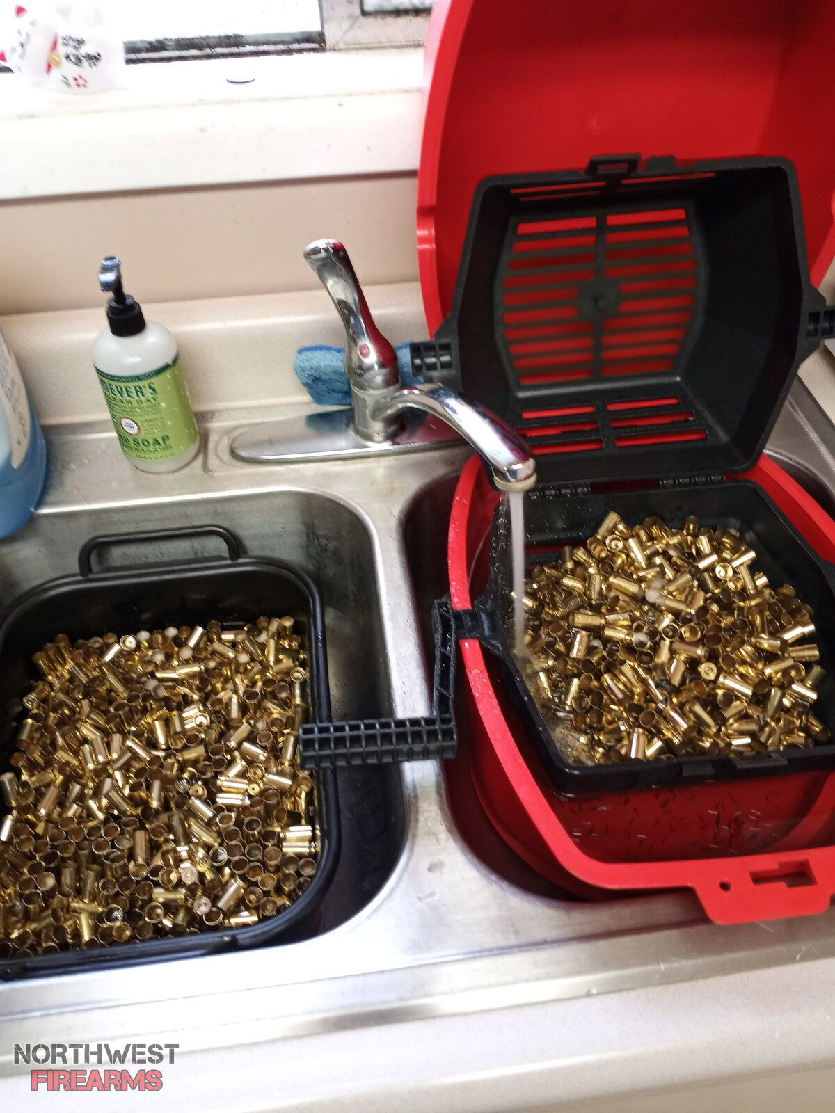

I had a pretty productive weekend, loading. Had a huge pile of wheel weights to melt down, made a lot of bullets and ingots. Got more .45ACP brass to feed the 625 from another forum member, and ran all that through the wash.
20201129_105040.jpg 20201129_105129.jpg 20201129_123844.jpg 20201129_130618.jpg

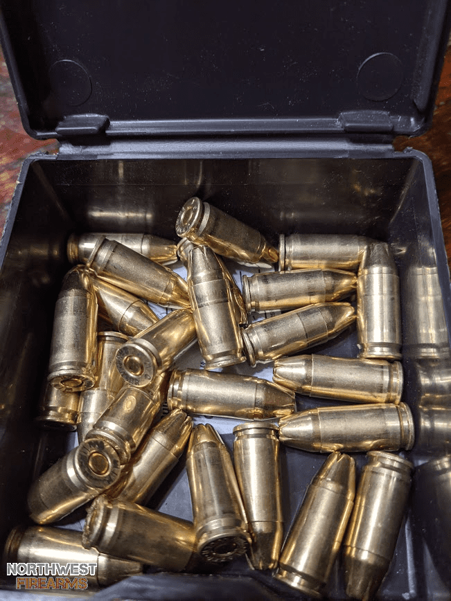

Loaded 10 more at 11.4 gr 1680 and will run them thru suppressed and see how we look. Expensive round to be working up. Hoping to get it done in less than 50..
200 grain Maker Subsonic solid copper expanding..

I didn't load anything, but I did wet tumble a bunch of brass, and I learned a very valuable lesson:
Don't tumble different calibers together that can fit inside each other. What a colossal pain in the azz getting all the steel pins out of all that brass. I also learned from my last batch of tumbled brass that too much Lemi-Shine makes the brass dull.
