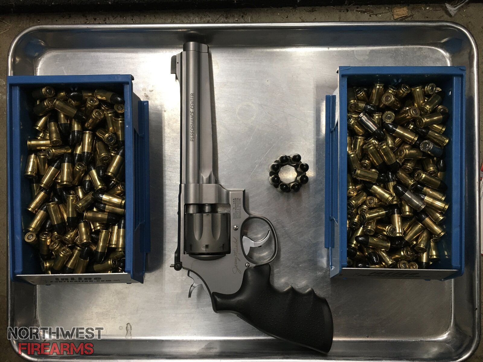

Loaded up another 1400 rounds of target loads over the weekend, .45 acp loaded like it was " short Colt", for my revolver. I think if I get down to 2k primers left, I'll stop loading til I get more, so as to leave a reserve for flexibility.

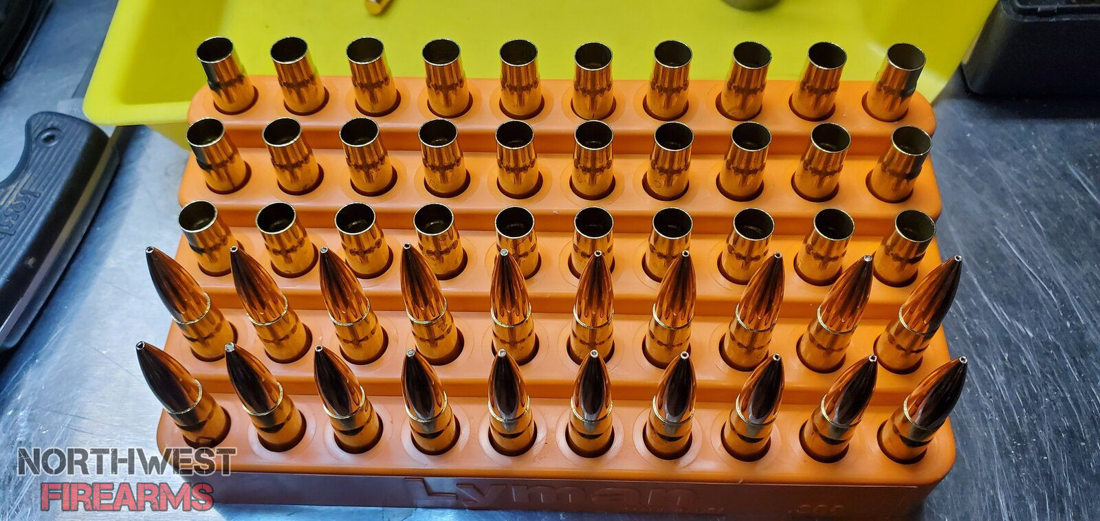

I loaded up (30) 204 Ruger test rounds yesterday. I have always had a decent load for 39 grain Sierra Blitz Kings but it wasn't real fast. Changed powder and think I've found a bit more speed. Also seems to work with 40 grain VMAX as well.
Might try to go test them today before dinner.
