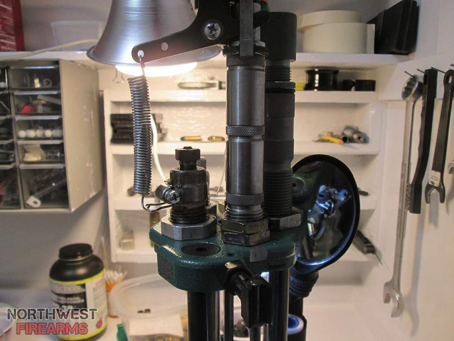

Press mounted light.

Yes, a light, and a mirror too

How about, I have no issues seeing the powder level in a walnut tumbled pistol case, especially with a press mounted light? :D
Show off... I too fight the "black hole" syndrome without cleaning up the brass... And yup, I have count them, TWO lights. Ah......I miss the days of youthful eyesight.
