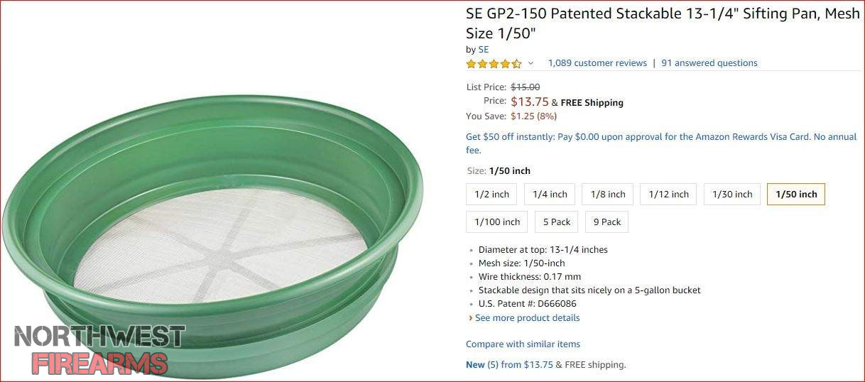

I know, I know..... I need a brass/pin separator. :oops:
Wow! That's a lot of work. I'm only using the Harbor Fright twin drums because I do small batches. As in 60rds of 223 in each drum. One hour run time max. But the pins are stainless steel. Why do you think they'll rust?
Try this for a separator.
