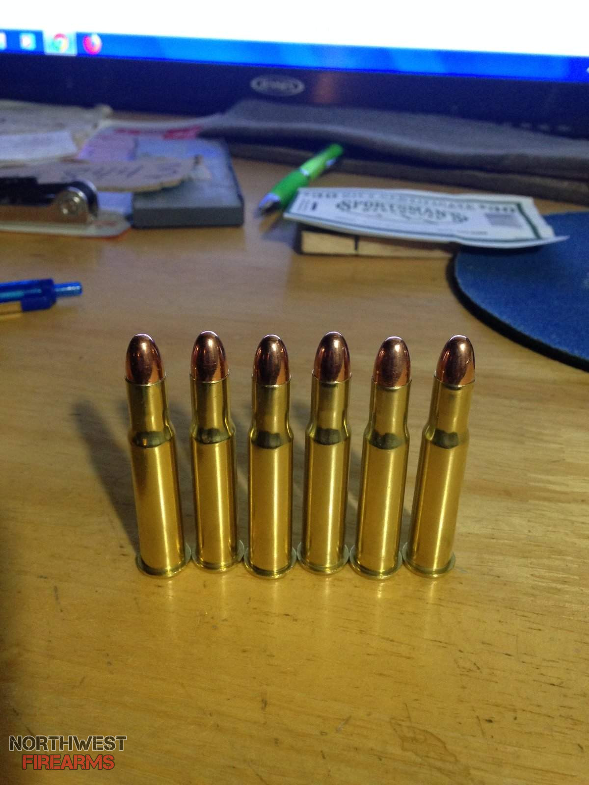

This is Dawn, lemon juice and about three hours on some 70+ year old 30-30 brass.
This is my typical result with any brass - new or old.
The cool part is the 'old' brass patinas to a deep, yellow orange color after a couple weeks
- and nothing further.
