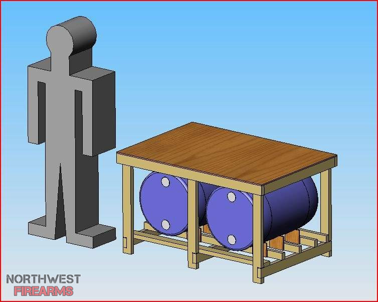

so tonight I took the time to model up a horizontal rack made from 2x4's. It has the drums set back a bit to protect the spigots and doubles as a table or shelf. I made it so I can add as many supports as I want to support the drums since they will weigh so much. I don't think it will cost that much for material, my cutlist is 7ea 8ft long 2x4s, 3 2x3s and one 4x8 sheet of plywood or OSB. Here is a screenshot, for scale I made a crude model of a 6ft tall person. Fun stuff.

I'm no expert, but wouldn't your rack be better (on soil) with another sheet of ply along the bottom? Kinda letting the entire rack act as a skid/sled in the event your soil liquifies, instead of tearing it apart.
As pictured I'd imagine that rack would be perfect on cement slab, in a garage etc.
thats a good point about soil surface but I designed the rack to sit on a concrete floor in my shed.
Its working great so far but I had to redesign the barrel supports from the picture shown....
