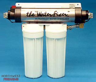

If you're industrious, a DIY dual filter and maybe a UV unit can work under many circumstances. Boondocking I typically process my own water from whatever's available using a DIY unit based off a unit like this:
Essentially just 2 generic filter housing from the adult toy store (Home depot, lowe's, etc) a 12v UV unit from online and powered by a 12v RV water pump (with a hand turned pump as backup.. that I can also stick a cordless drill on). You simply stick in whatever common filters you desire to fit the level of filtration required. It does about 4gal per minute (determined by the UV chambers time required to do it's thing) from any available water body to refill my onboard potable water tank.
