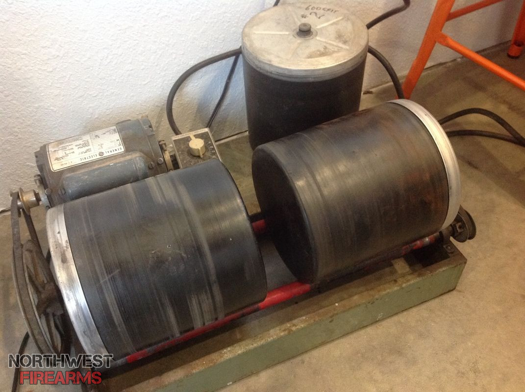

This is my tumbler. I'm not sure if the drums are waterproof, I'll test them later. I tumbled my brass for five hours but I didn't get the results that I wanted. It took me an hour to fish my brass out of the media.

Most of the time you're going to want to let it run for 4-8 hours depending on how tarnished the brass is, you're never going to get a real shine from walnut, it tends to leave a dull burnished finish, however it does a good job of cleaning stains off. If you want bright brass, corncob is your friend.
Stainless does work, and works well. however you need a rotary type tumbler, which looks to be what you have, I think that's a HF rock tumbler, and it's probably waterproof enough to do the job for you.
There are a few options as far as SS media goes... there are the pins which are the most common, there's also another stuff called Jewelry Mix, which is commonly used for polishing jewelry, it's rounder but sometimes it gets stuck inside the case depending on which cartridge. It all works, but it's damn expensive stuff. Lemishine works, however I just use powdered laundry detergent for wet tumbling, and then do all my finishing in corncob.

Decap, resize brass
rock Tumbler
5 lb stainless steel pins
squirt of liquid dishwashing detergent (wife buys dawn)
pinch of lemishine
water from garden hose
Takes about an hour, do it outside, always leaks.
media <broken link removed>
garden hose washing while cranking the media separator, water is now black ick, brass is golden
pour wet brass into food dehydrator set temp to about 140 for an hour.
I store them in gallon juice jugs till ready to reload
