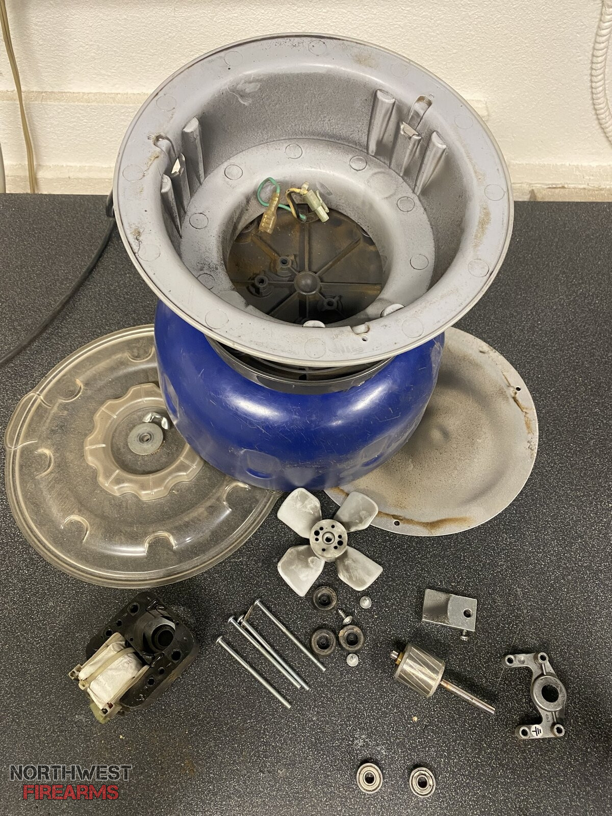

I've been using this tumbler since 2009 and it's been good for my needs. I had to re solder a cold joint once a few years ago but, other than that it's been solid. The other day it started groaning and randomly bogging down.
I took it apart and found the bearings were starting to seize up. I looked up the part number on amazon and found a 4 pack of bearings for $6. Spent about 10 minutes putting it back together and operates like it should.
