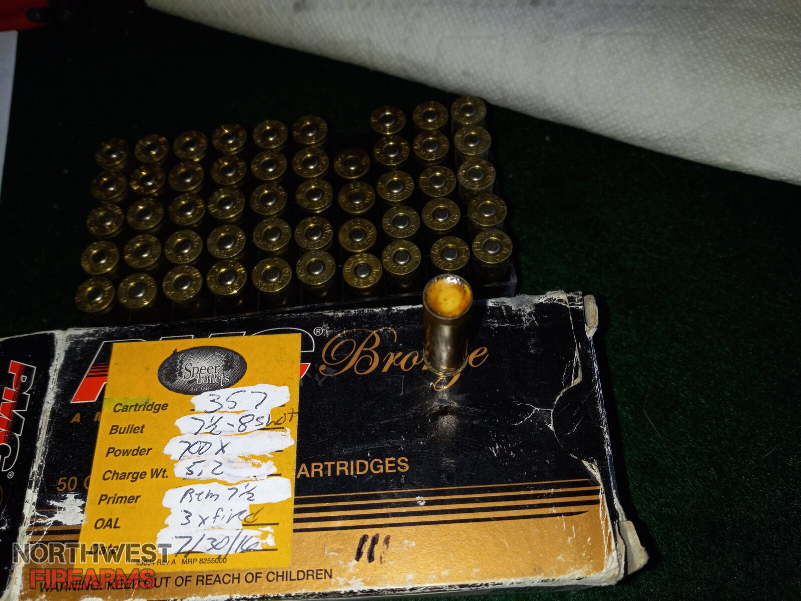

You don't really need the kit. I make these in 38 and 357 but really I could make them in any cartridge I wanted to. 5 and 1/2 grains of hp-38 works pretty good too. Out to 10 ft anyway.
You just Flair one of the cases that you're going to use it for and cut out a bunch of cardboard wads after sharpening the neck. Then you put one wad over the powder and another wad over the shot. Then crimp. Lots of things you can use to seal it. I like to use some Titebond 2 wood glue and some bullet Lube just to keep the leading down. These are not a high pressure load because there is no projectile blocking the barrel as the gases expand. Any amount of powder is probably okay as long as it is not too little to blow the shot and wad out. Different cases will have different requirements of course. Especially when a case starts getting necked. This is where my old 38 & 357 cases go to die. They just become a shot cartridge.

They look to me like gas checks, so made to be shot. But I have always made mine from cardboard. two or three layers over the powder and one on top to keep the shot in place. then glue in place with a watered down white glue. I weigh the shot to make it about the same as a common bullet weight and then find a dipper that drops a close amount. DR
