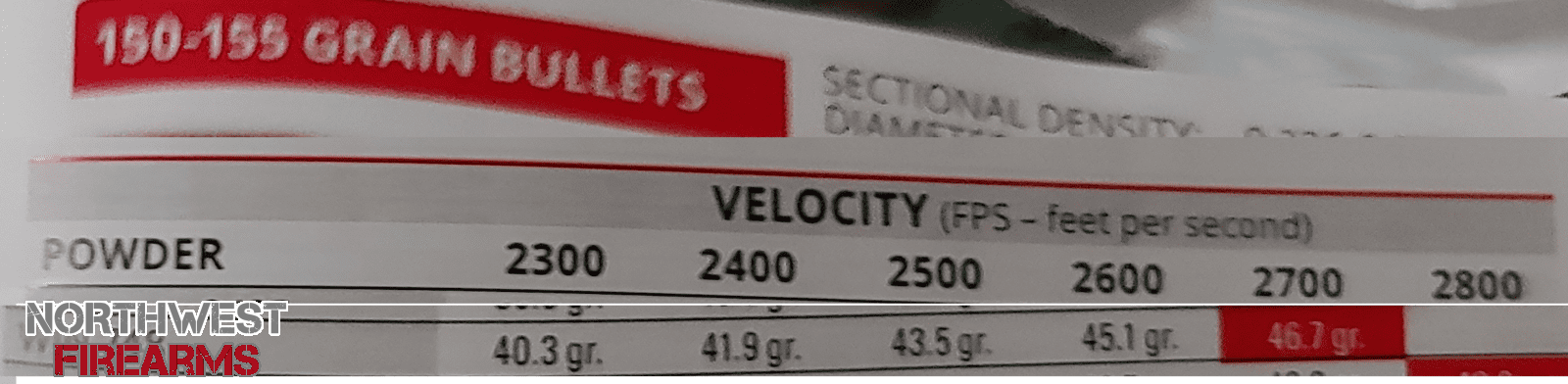

Your loads are definitely shooting faster than the estimates published in the Hornady manual (forgive the late night careless photo edit) but that could be due to a lot of things, not least of all differences in their barrel and yours.

Anyway, as mentioned by someone above, perhaps the Tavor is supposed to eat cases. It's primary purpose is not a range toy to give joy to reloaders -- it's designed for more serious use cases where a failure to function could be far more significant than whether reloaders like the brass it spits out. If I were in your shoes, I'd work on something that I know how to do -- figure out which load gives you the best group and best ES. Perhaps answers to the brass questions will turn up as you go.
