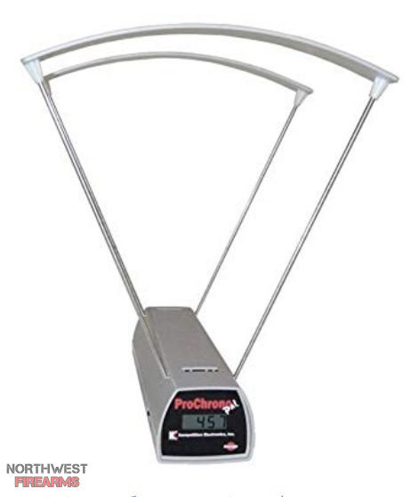

Keep in mind that if your chronograph is the type that uses the two overhead screens like this...
.... a canopy may impede its proper functioning as it requires a lighted background so it can read the "shadow" of the bullet passing under the screens.
