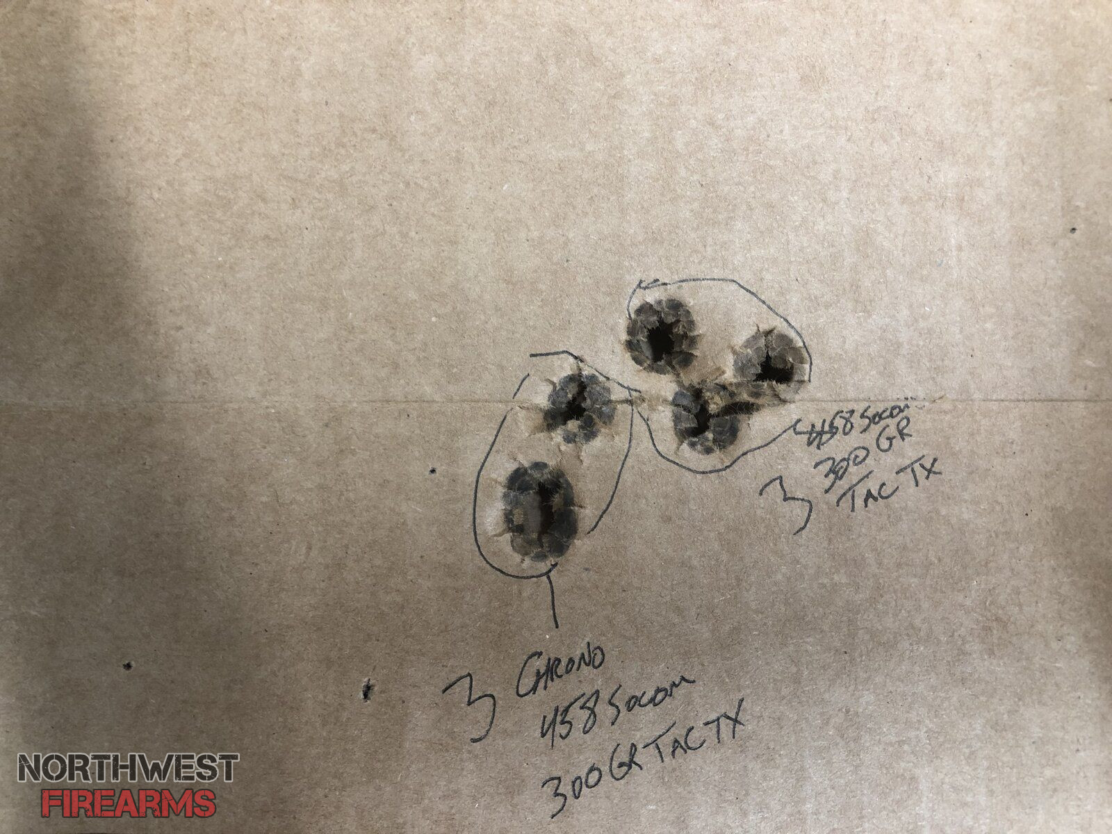

Nice results. For me I have found that it actually tightens up my groups most of the time which is why I do separate velocity and precision tests. Using the magnetospeed has actually caused me to consider getting some of those weights you attach to the barrel for that purpose.

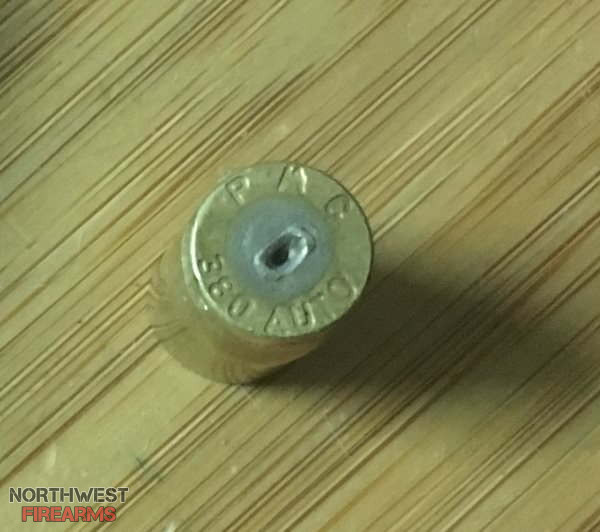

Here's one for example. Scary high pressure, right?
Well, actually not. I found this one on the ground at the range. The brass was bulged such that it was clearly fired in a 9mm. I believe that due to the poor headspace, the brass moved forward in the chamber when hit by the firing pin, the primer backed out upon detonation, and then once the bullet hit the rifling the chamber pressure pushed the case fully back, flattening the hell out of the primer. The actual chamber pressure would have been less than a normal 9mm round.
I've seen this with revolvers too. I once had a S&W 686 that would flatten primers on everything because of this.
