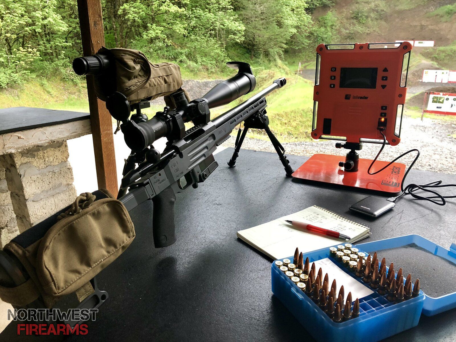

Wow I didn't realize the labradar was so cheap, for some reason I was thinking it was a couple grand. The FX is a birthday present to myself.. any other day its really not in my budget. I also returned my $70 frankford arsenal platinum scale and my hornady ultrasonic to help finance it. I bought an ultrasonic and a wet tumbler off amazon knowing that I could return the one that didnt work the best. Wet tumbler won hands down. I'll probably buy a different ultrasonic down the road to clean gun parts since that's nice to have but the hornady is pretty tiny.Wow -- if you bought a scale like that, why didn't you get a Labradar? Labradar: The new generation of ballistic velocity radar | Labradar

Wow I didn't realize the labradar was so cheap, for some reason I was thinking it was a couple grand. The FX is a birthday present to myself.. any other day its really not in my budget. ...
