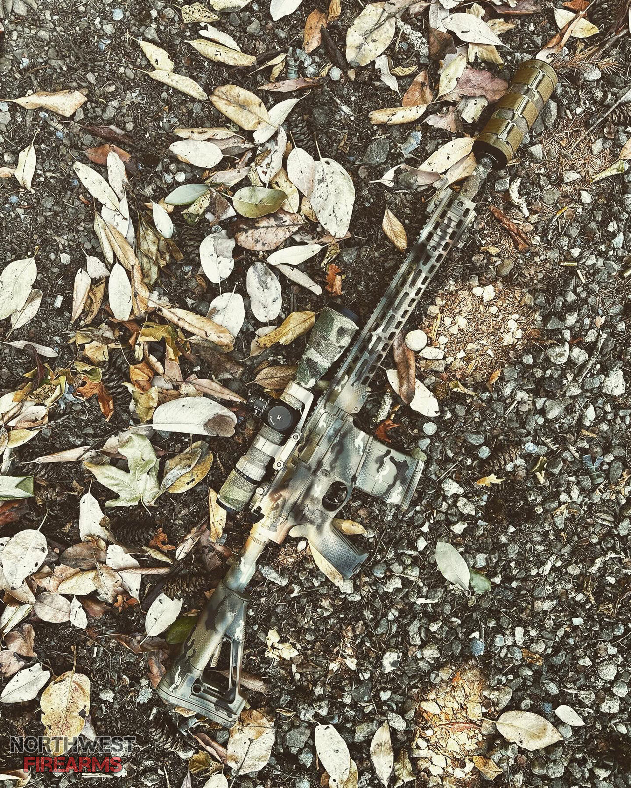

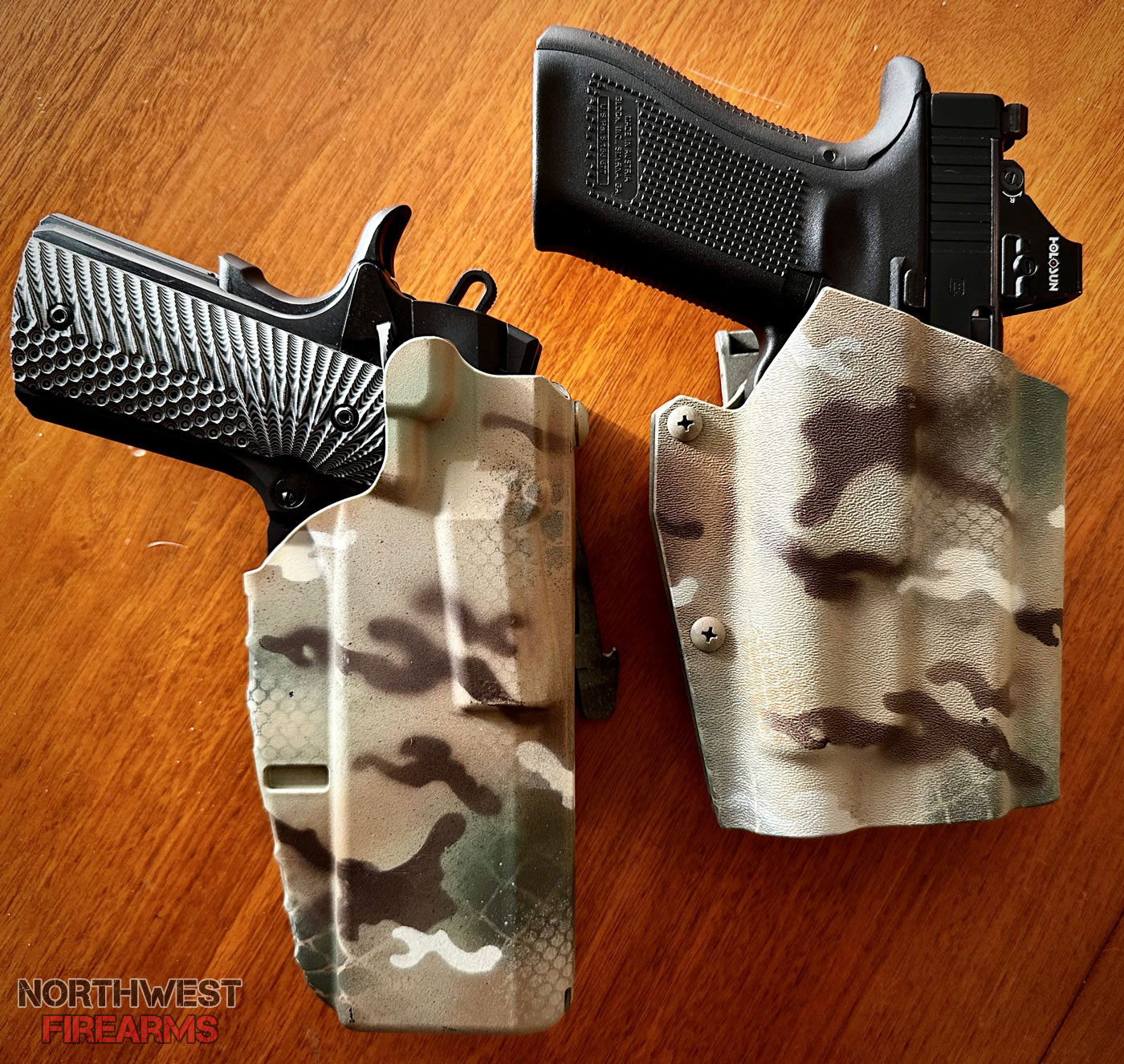

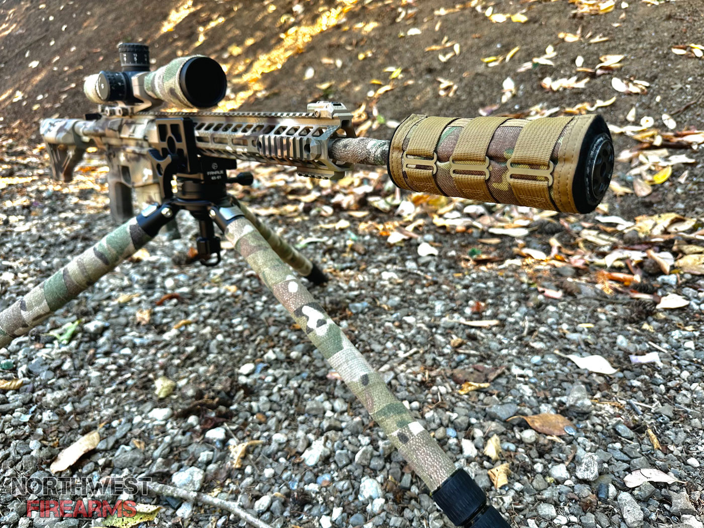

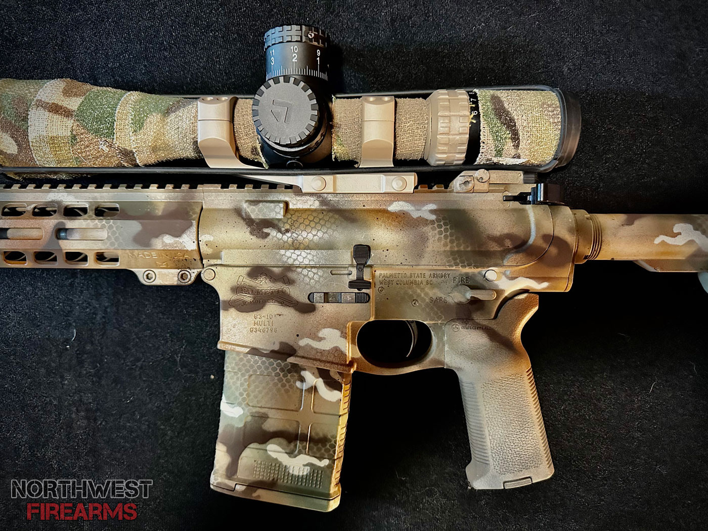

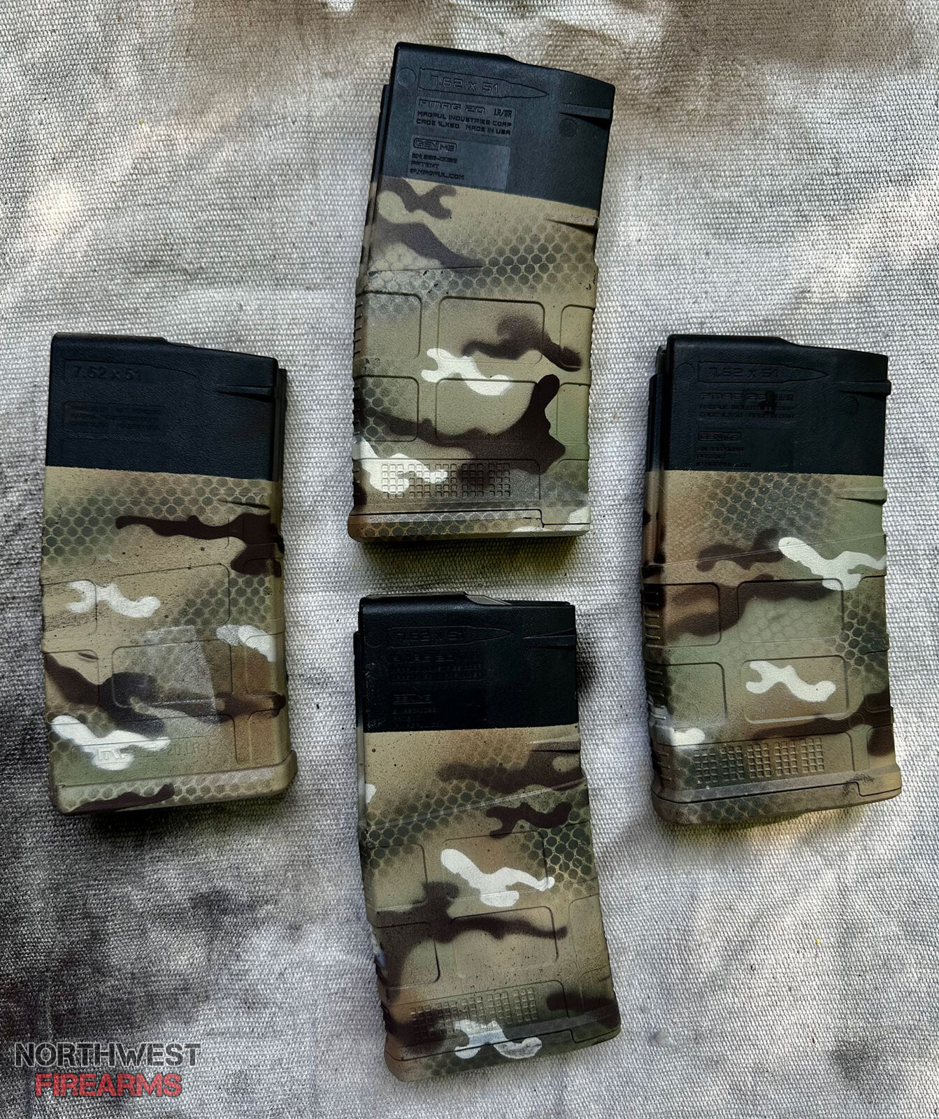

I've used a mix of Krylon and Rustoleum for my projects and have gone from one to the other only for color preference. Never really noticed one or the other lasting longer or having more/less protection. Both last really well on plastic and kydex. I just have to be more careful with cleaning solvents than with unpainted guns.
View attachment 1465120 View attachment 1465121 View attachment 1465122 View attachment 1465123 View attachment 1465124
That looks fantastic. Are you using stencils?

Thanks! I use a couple of different sized net patterns from a laundry bag, trunk cargo net, net bag that had oranges in it (lol). I did use a stencil from Amazon (taped off the parts I didn't want) and used them here and there.
Those camo patterns do look really nice. I haven't done any patterns like that (yet), but I've looked at quite A LOT to get ideas, and yours are very well done. Nice inspiration.
What kind of wrap/tape is that on the scope? I may try something like that.
It's called Camo Form from GearAid. There are other brands on Amazon, but this is the OG. Much better than the others.
Good to know, thanks. I use GearAid repair products and keep them on hand - a trusted brand. Did not know about this product. Glad you posted your pics to further the discussion.
