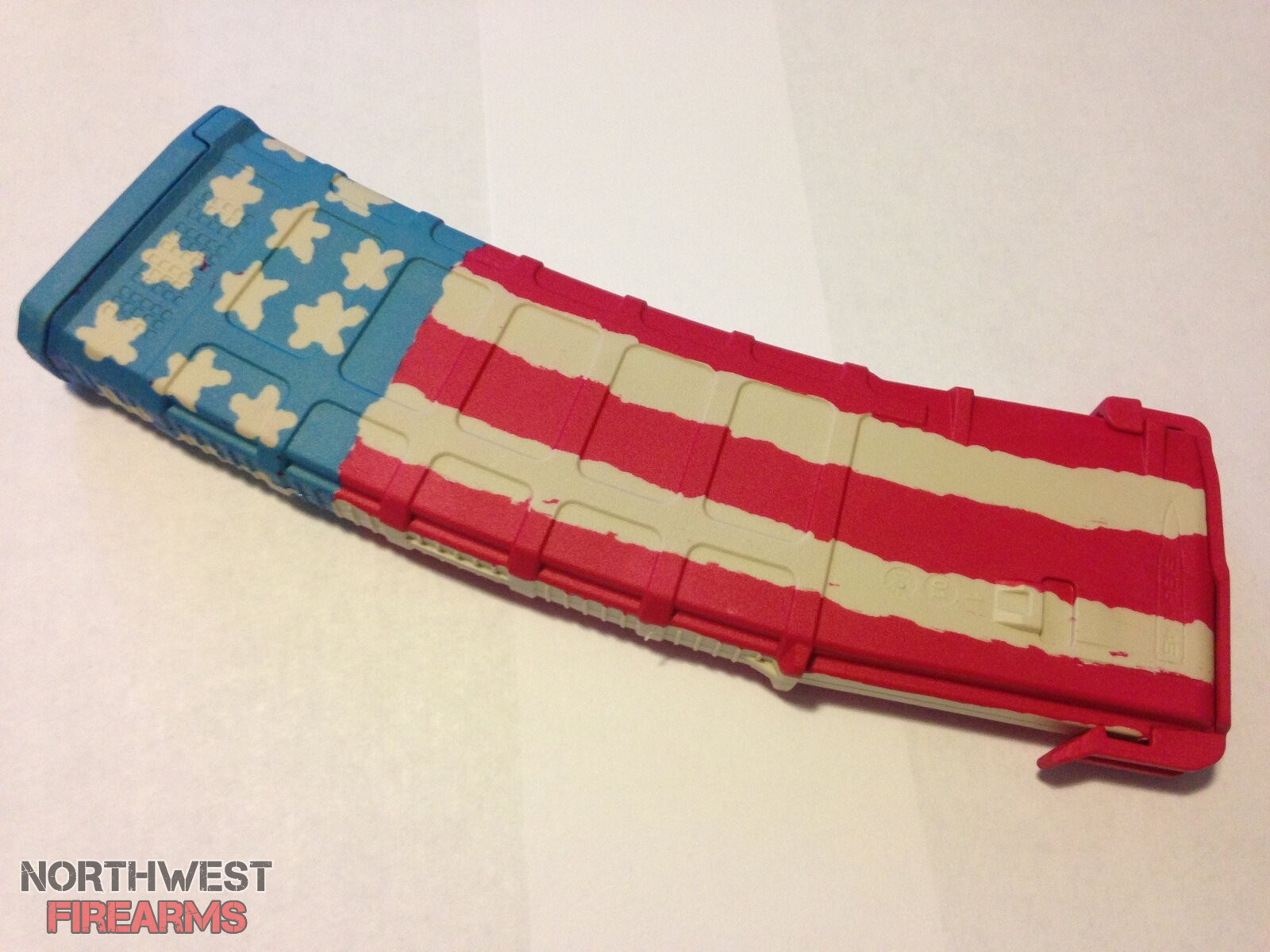

I'm not sure if magpul makes the sand colored 300 blackout mags. If they do, I recommend Rit Dye. It penetrates the plastic and lasts, essentially, forever.
I've done bright blue for a blank only mag, and if you have a hot glue gun, you can get a little creative. The glue blocks the dyeing process and though a pain in the rear to peel off, makes for cool designs if you want to take the time.

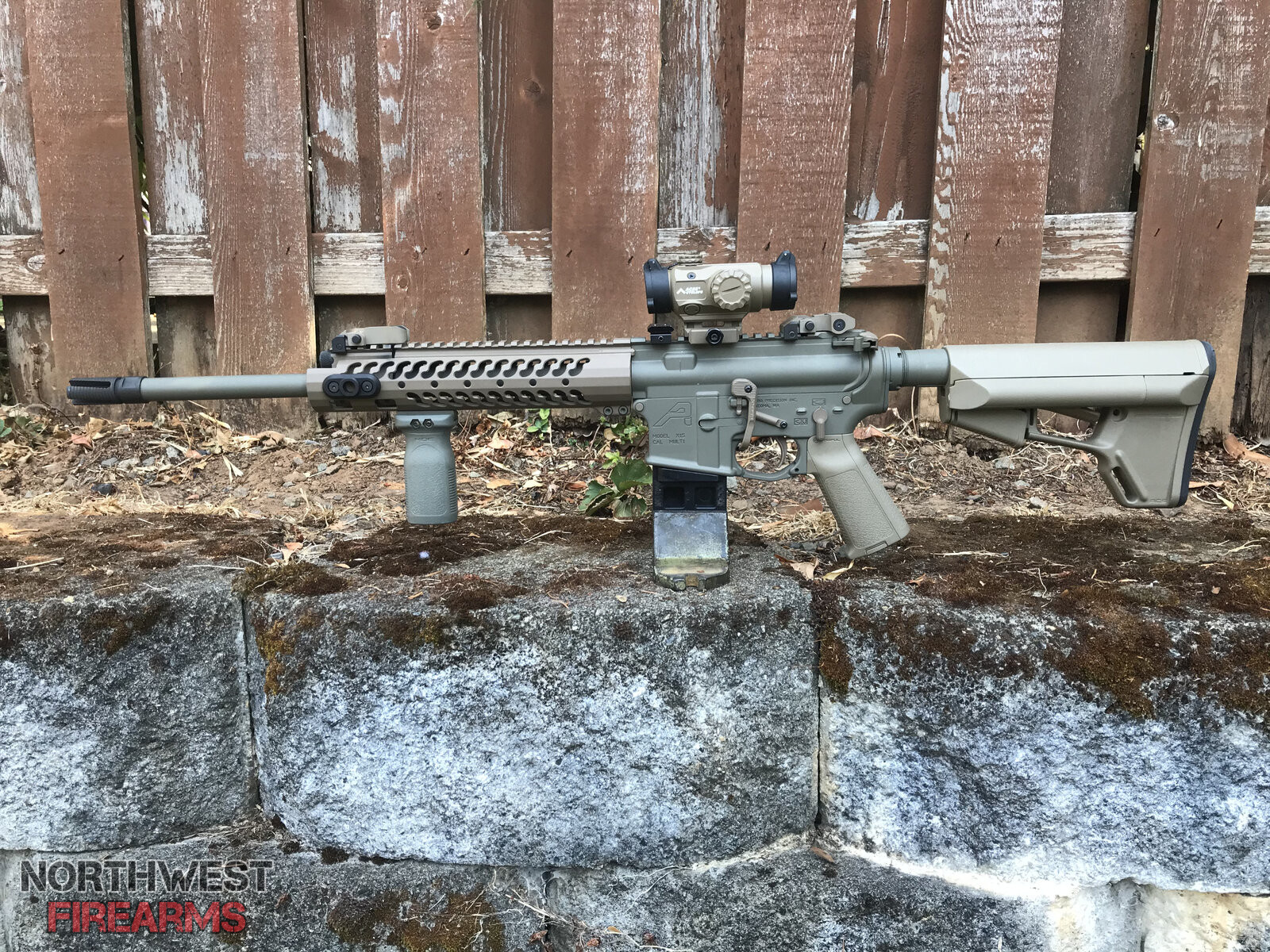

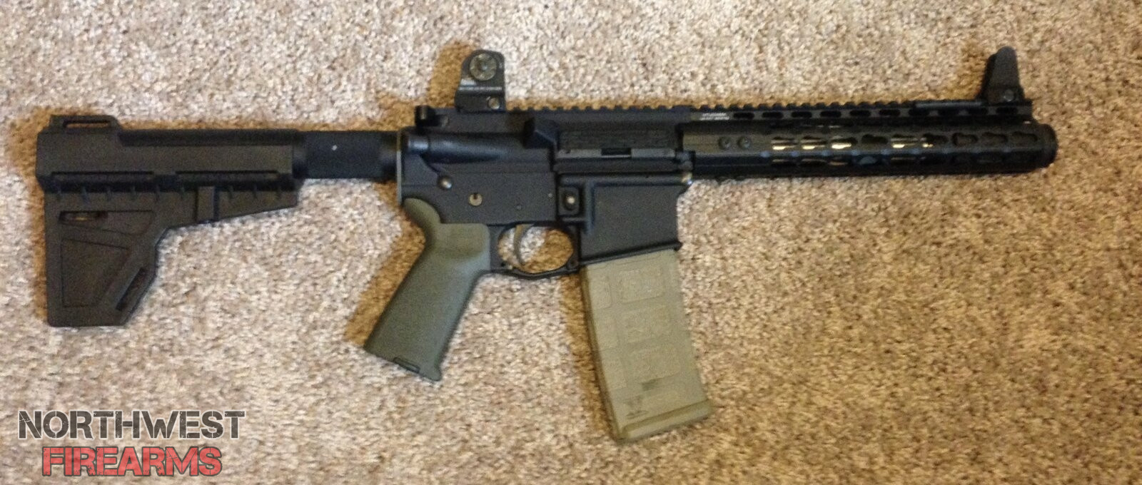

The upper and lower are a combination of FDE and foliage green. Black is serviceable and has it's place, but stands out and gets hot in the sun.
The 300 BO upper will follow this pattern and will use the same lower which is being SBR'd.
