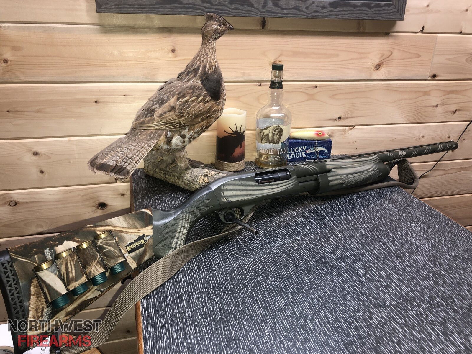

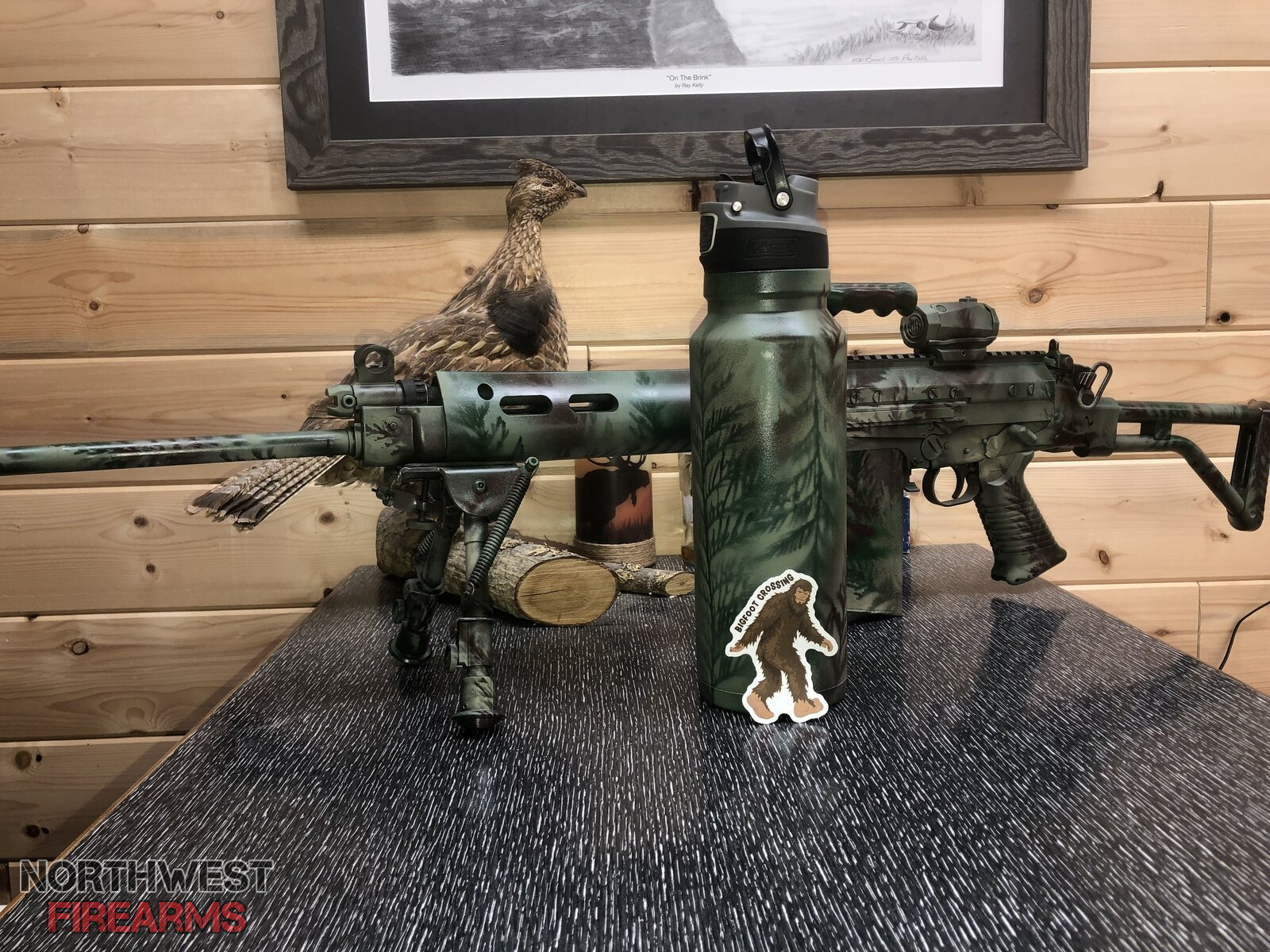

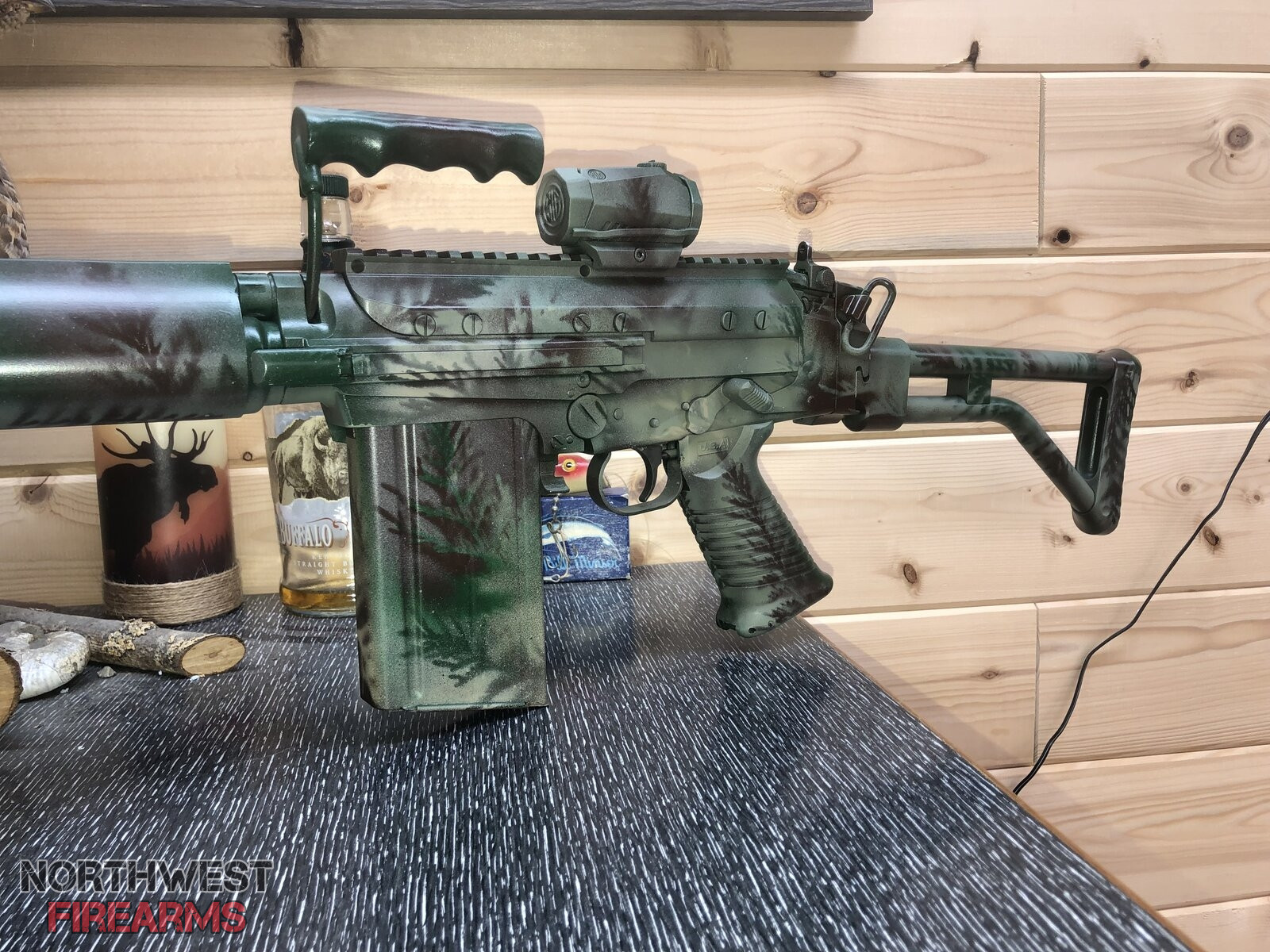

Years ago I rattle canned a shotgun for duck hunting that has held up well and still looks great after almost 40 years. With that in mind, I prepped a magazine and practiced on it first and then got serious on my coleman water bottle. Satisfied the gun wouldn't turn out like azz, I did a thorough degrease and taped up some of the areas I did not want paint on. A base coat of hunter green with some dark brown slashes followed by a light sage green sprayed over cedar boughs from the yard, gave me the NW forest look I was after. I will be painting more after this experience.

so guessing the base was the dark green, correct? then layered lighter colors over. but how did you get the foliage edges so crisp?
Go pull some ferns/fir tree branches/grass/maple leafs/arborvitae/other plants and lay them directly on the firearm. Spray directly above them and not from the side.
Look guys, if a knuckledragger like me can pull this off, you are all pretty much capable of doing it. Yes hunter green base coat first and lay the cedar boughs tight to the rifle and spray locally and lightly. If you F it up you can respray so don't stress. Practice on something you really don't care to much about is recommended though.
Start with your darkest color as the base and work to the lightest color.

Also wear gloves if you don't want to sport camo hand paint on your stencil holding hand for a few days. I omitted this step. Here is my duck gun I painted almost 40 years ago. I have done zero touchup on it since and it has had some rough treatment.
