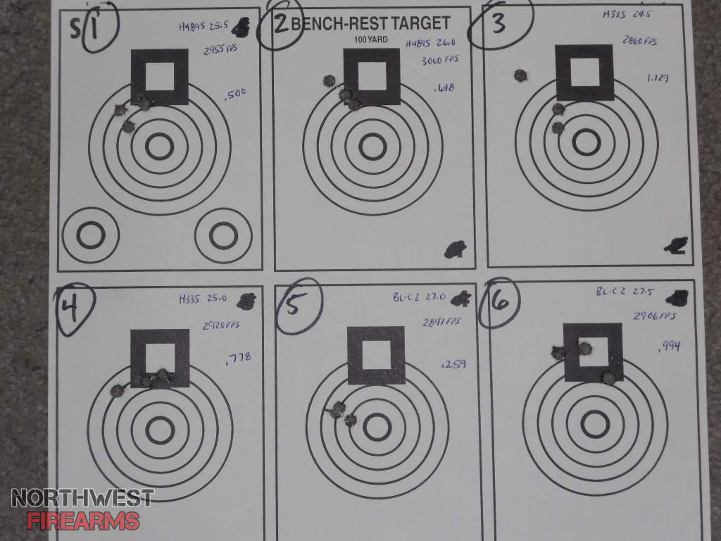

Had a good day at the range today testing some loads for a Remington Model Seven Stainless in 223 Remington. Ten 3 shot groups fired at 100 yards from a rest, calm winds about 38 degrees this morning. Shooting all groups with 55 grain Nosler Ballistic Tips. Scope used was a Leupold VX-3I 2.5-8X36 with a Boone & Crocket reticle. Marked on the target with a sharpie a number in the upper left box of the target that references the powder and charge weight for that group. All loads seated at 2.322" over all length (10 thousands off lands). Fired 3 shots of each load for group then two shots of each load through the chronograph. Group size measured center to center, or outside to outside furthest spread minus bullet diameter.
1 H4895 25.5 Grains 2955 FPS .500" Group
2 H4895 26.0 Grains 3060 FPS .618" Group
3 H335 24.5 Grains 2860 FPS 1.129" Group
4 H335 25.0 Grains 2920 FPS .778" Group
5 BL-C(2) 27.0 Grains 2841 FPS .259" Group
6 BL-C(2) 2735 Grains 2906 FPS .994" Group
7 H322 22.5 Grains 2732 FPS 1.056" Group
8 H322 23.0 Grains 2795 FPS.573" Group
9 Varget 27.0 Grains 3027 FPS .677" Group
10 Varget 27.5 Grains 3060 FPS .521" Group
27.0 Grains of BL-C(2) was the tightest group at .259" but was fairly slow at 2841 FPS.
27.5 Grains of Varget was a very respectable group and good velocity at 3060 FPS.
26.0 Grains of H4895 @ .618" and 25.5 Grains of H4895 @ .500 were more consistent with good muzzle velocity of 3060 FPS and 2955 FPS respectively.
I think I'll go with the 26.0 Grains of H4895, good velocity, good consistency with that powder, and I just bought an 8lb jug of it a while ago, so I have lots to use!
