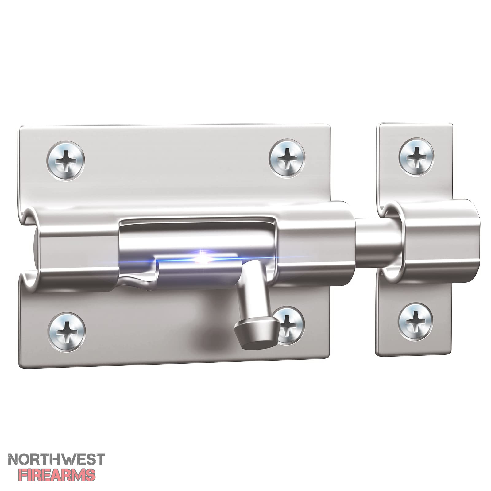

Here in Texas, a teacher who I believe was out of the El Paso school district, has designed and is selling a new style door lock to put onto interior classroom doors in case of a lockdown/active shooter. The reason that this is so important is because on most classroom doors teachers must step out into the hallway in order to lock the door!! With this lock one drops the piece into the locking pieces in place on the door and the jamb. Those two pieces have a small cavity in the back that the 90* piece into those two cavities. And its locked tightly. Pretty ingenious if you ask me. This only works on doors that swing open away from you. Comes in 90* right, 90* left and one that is flat.
Could really be in every school in America. I'm putting one on my back door (swings outwards).

I guess that just installing a double dead bolt lock with a uniquely coded inside key for the teacher wouldn't work for some reason ?

I can see that potentially being a code issue depending how strict a locality is about egress systems. Sure, it's meant to be a temporary thing for emergency use only, but that doesn't stop the fire marshal or city inspectors from giving the business a discrepancy because of some outlandish excuse like "ok, so how would someone with no hands remove that device to escape when the building is on fire?". I would be lying if I said I haven't witnessed an excuse like that get used before.

In commercial door locks, there is "Classroom Function" and "Storeroom Function".
Switching classrooms to storeroom function locks might be a way to go.
The teacher would have to see that the door is open as the class fills up and then it locks upon closing the door.
A storeroom function always requires a key to retract the latch and enter the room. A classroom lock can be locked or unlocked using a key in the outside lever. For both functions, the inside lever always allows free egress.

I actually had a private school pay me to install Entry function levers where they originally had Classroom function locks, so the teacher would be able to lock the doors from the inside in case of trouble

Although a 5 year old kid could close a store room function door and have to do nothing else to lock the classroom.
Either way, classroom function is obsolete when you think about it.
