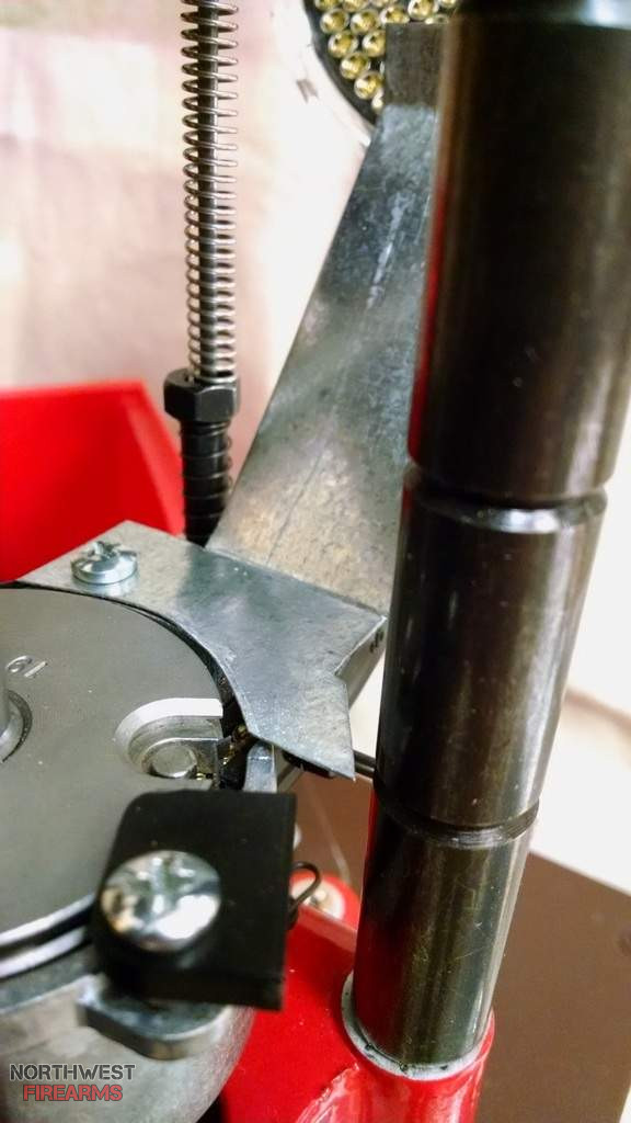

1st up: Primer explosion shield. Lee recommends against all but a couple of brands, and while I tuned the press with CCI, I intend to use S&B. Whether or not the S&B will feed/press reliably I have yet to find out, but I felt some type of shield prudent.
Just galvanized sheet metal cut to fit - I do hope that I don't get to find out it's effectiveness.

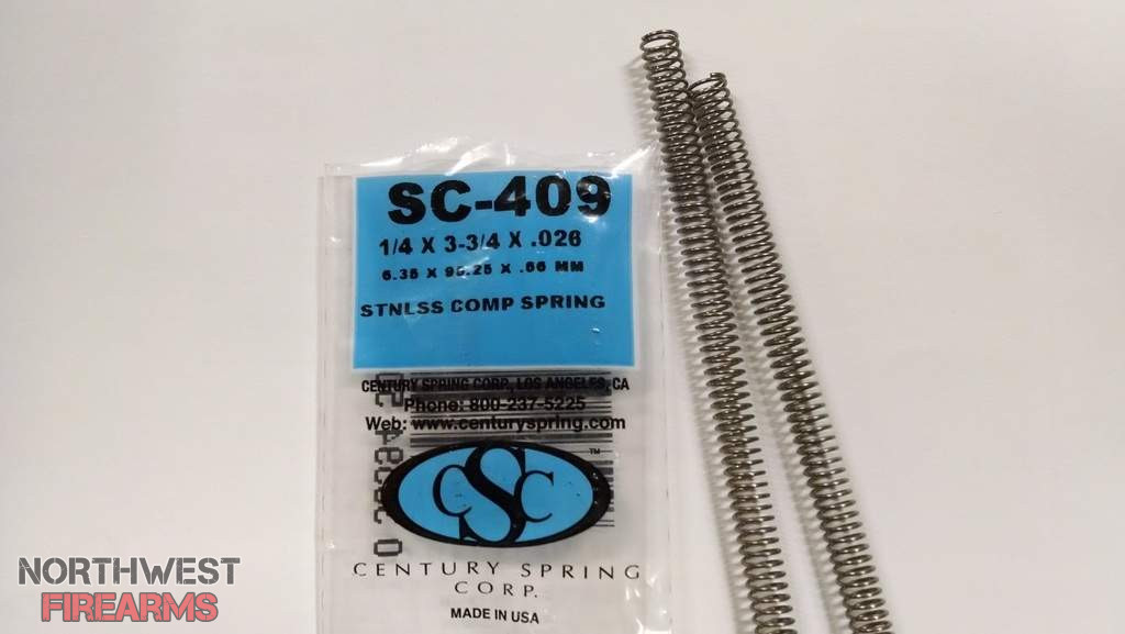

Next up is the bullet feed actuation rod. It operates off friction - the little nub you see cutoff is the friction part that wears.
Sure, the part is $2 from Lee - but I, hopefully, rebuilt it for a lifetime's use.
Parts necessary (Parkrose, for all you Vantuckians :) )
