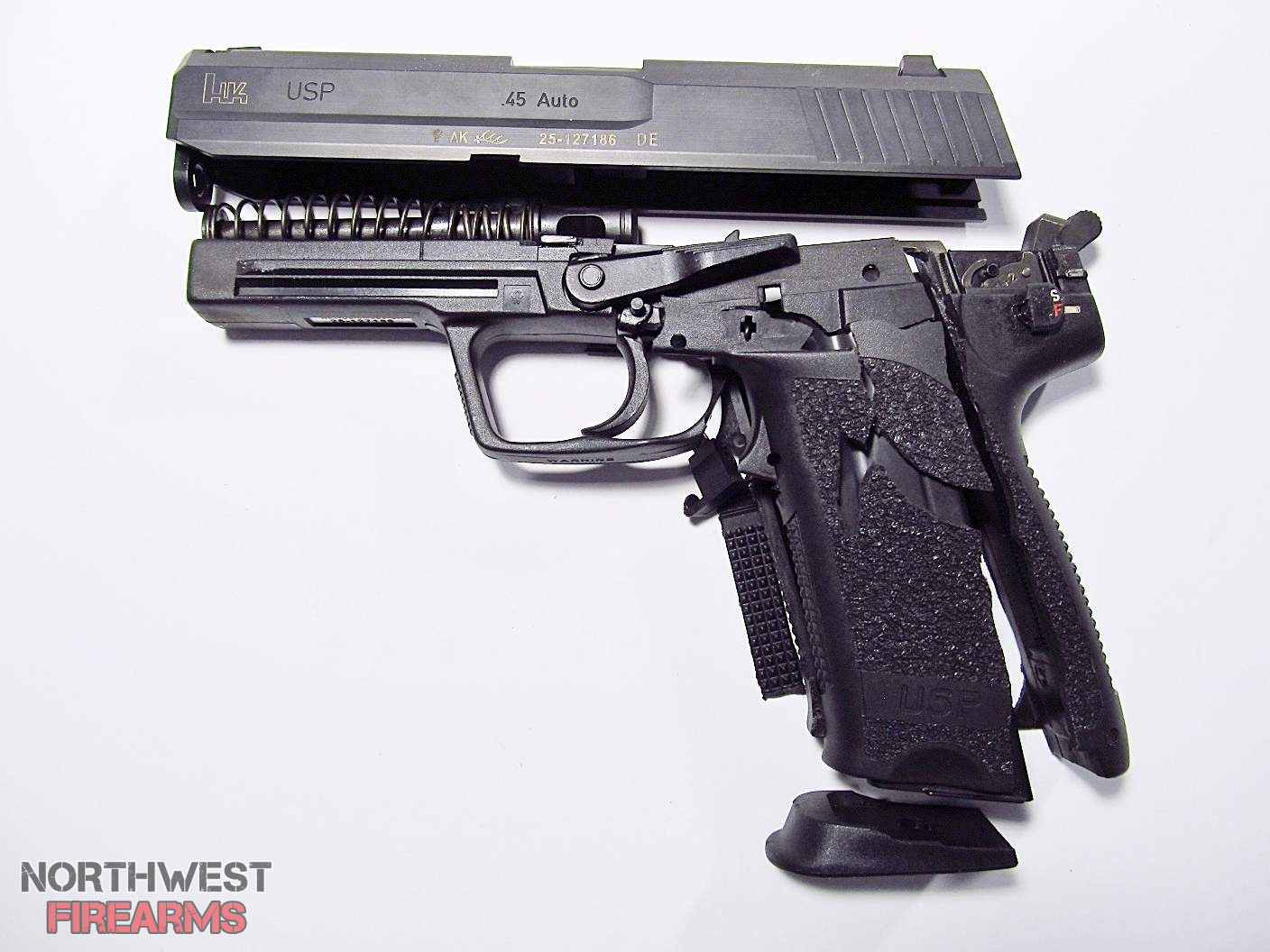

Okay, you got me! The only tupperware KB's that I have seen the accounts of were on HK pistols.
My "kaboom" from 2015:
I think I get the tupperware reference. lol Nearly zero injury with gloves & Oakleys. I'm glad to hear that you were okay also.

Again, glad you came out uninjured. I'd send it in to have it checked, as previously suggested.
I loved my USP, but that is painful to look at!
Pieces were all over the ground. My buddy managed to pick up every single pieces while I stood there in utter shock. lol
The unfired bullet setback is what bothers me. It can happen in the magazine from recoil if not properly crimped and could have caused setback and overpressure on the case that exploded, but very rare to see something like that.
My apologies if I'm mistaken, but is this what you guys are referring to?

I looked up as many online reports/write-up of USP "kaboom" as I can at the time, and every single one I found involved reloads. It does seem to be very rare occurrence with factory ammo. *edited

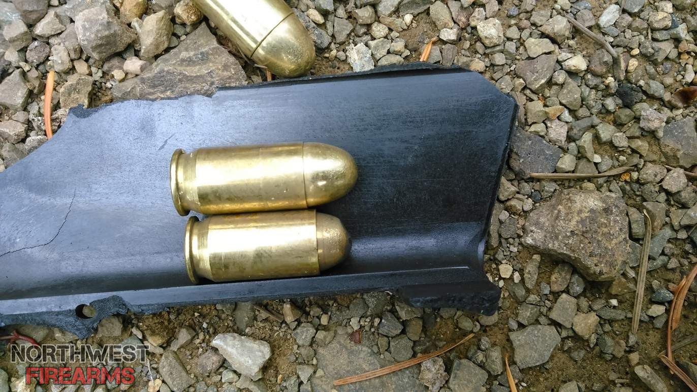

Looking at the bullet setback on your other cartridge, I'm thinking either your crimp or weak brass is the most likely suspect.
Rather than just try the push test, have you ever actually measured your crimp at the case mouth? I crimp to 0.376-0.377" and only get setback if chambering the same cartridge multiple times. You should also pull at least one of the bullets and examine the depth of the crimp ring.
~10 lbs before setback seems low to me, especially considering most recoil springs are usually in the 18 lb range iirc.
If it's range brass, it could have also just been a piece of pregnant Glock brass, or even 9mm Major brass. If it did have the Glock belly bulge, I'm surprised it chambered. I get a few every now and then that are still bulged enough to jam, even after resizing and a Lee factory crimp die.

God smiled on me today. Brother and I were out at the end of the range of Wolf Creek where North Fork Road turns into Sunset Grade. We're both shooting 9mm pistol loads I developed for my R51, he shooting his Hi Power, me using my R51. We are doing slow fire, and our shots are nearly synchronized. I take a shot, and my gun, which had been recoiling very nicely, suddenly feels like a very hot 44 Mag load. I think, WTF? and watch as the contents of my magazine drop out.
There are black powder marks on both hands, the slide is only partially opened (~3mm), and it dawns on me, "I just had a kaboom."
Nothing in my face, and no injuries.
I eject the formed magazine sleeve (all that remains). Found the spring, spring retainer, and follower, but never found the heel plate.
The R51 handled it very well. My presumption is double charge.
When I loaded these rounds, I double checked OAL and bullet retention (i.e. could I push the bullet back into the case).
Now to completely strip and clean the R51 and do close inspection for any damage.
Looking at all the bullets I picked up from the ground, I note the unfired one in the photo has been severely pushed back into the case and the mouth belled.
View attachment 563021 View attachment 563022 View attachment 563023
