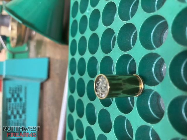

How about 9 grains in a 9mm case? I haven't loaded W231 in many years but with recent powders I've used, it would be all over the shell plate.
For instance, if I can place 8.5 gr Blue Dot (flaky double base) in a 9mm case, then I should easily be able to put 9 gr W231 (ball powder) into a 9mm case with no spilling on the shell plate.
I'll make you a bet ?
Do it and take a pic, please. I'd do it myself if I had any 231.
Not sure if you could seat a bullet and maintain COL, but here is what 9.0 gr of W-231 looks like in a Dillon RL-550 Dillon sizing die Winchester 9mm case. I think a double charge would have disassembled even a steel frame gun. I vote for the bullet setback theory. CAE435C9-AF2A-44FD-B183-161D1C9E0898.jpeg
Sure as heck, it didn't spill over. I agree that attempting to seat a bullet on that charge would be unlikely to slip by, but I've seen stranger things happen. Thanks for doing the test and the pic.
