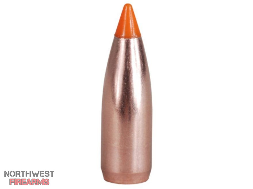

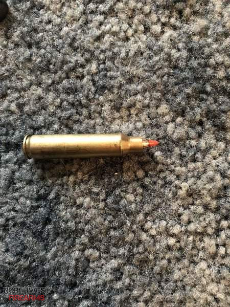

You probably drove the bullet into the case when you tried to ''Shove a rod in there''.
I asked about ammo twice?
I'm beginning to think were helping a drunk guy get his car out of the ditch. Just to drive off and kill himself.
Im curious on the ammo too... I also agree with your assessment on how the bullet got driven into the case.
I've had jams like this from loose primers as mentioned before and from steel cased ammo (with lacquer?) sticking in the chamber. Pro tip: You can pry between the carrier and the ejection port, but no matter how well you wrap your pry tool in cloth or tape it will probably still mar your upper. Aluminum be like that. :rolleyes:

Or a reload using that bullet that was not sized correctly causing the jam.
