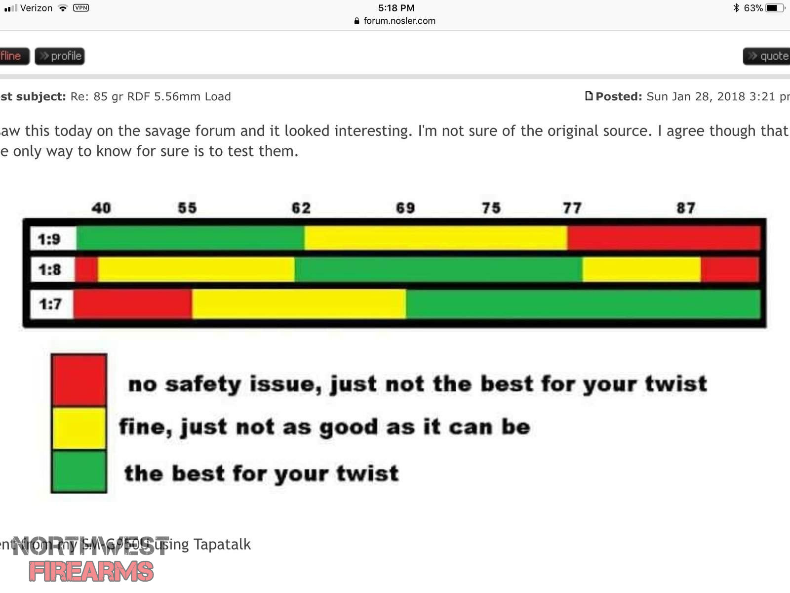

20 or more years ago, twist rates that favored lighter bullets were common. Today, it is more common for higher twist rates as the popularity of heavy bullets has increased. Several bullet manufactures offer tools to determine ideal twist rates.
I like to use the tool at Berger, Twist Rate Stability Calculator
which lets you calculate what twist rate is optimal, marginal, or not recommended.
My Rem 700 223 only has a 1:12 twist rate which limits my bullet choices to 65 gr, though my ARs have either 1:9 or 1:7 allowing a heavier bullet. There is a condition where having too much twist is not recommended for some bullet weight/Velocity combinations. That is why the stability calculator is handy to help you avoid sub-optimal situations. When using the berger tool for non berger bullets, realize that other bullets are likely constructed differently so there's no guarantee the data is valid. Reasonable place to start though if your chosen bullet manufacturer doesn't provide twist rate recommendations.
